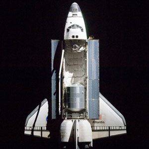

*Controlling the temperature of something in a vacuum is a surprisingly precise balancing act. You must insulate it so its heat doesn't all leak out by thermal radiation (the warmth you feel radiating from a hot stove, for example, is thermal radiation), and control how much you radiate out so too much heat doesn't build up in your insulation from things that produce waste heat like human beings, computers, engines, life support devices, etc. Spacecraft generally have specialized heat radiators for this purpose, that can radiate a variable amount of heat to keep the craft at the right temperature.
In fact, the Space Shuttle's cargo bay doors are lined with heat radiators - that's what the reflective material is - aluminum with tubes running through it of coolant, wrapped in mylar. They're essentially air conditioners, but instead of using fans like air conditioners for your house would, they use thermal radiation (I think they even use Freon, iirc!). If the cargo bay doors were to jam, the shuttle would have to have pulled an emergency abort back to Earth.

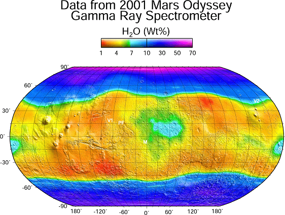

Water:
http://phoenix.lpl.arizona.edu/edu_water_ice_dirty_ice_snowcones.php
Water + RTG, fission or Solar power = Oxygen.
Soil is also rich with peroxides and nitrogen.
