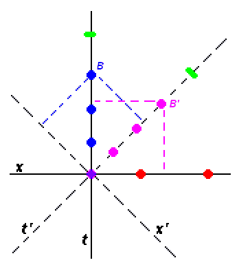

Frames in motion relative to each other simply do not measure distances and times the same. One meter as measured by me would be 1/2 meter as measured by someone moving at 0.866c relative to me, and vice versa. One second measured by me would be 2 sec as measured by him, and vice versa.
Exactly my point. Both perspectives cancel each other out.

However, according to the muon, it is the Earth clock that undergoes time dilation by a factor of 22, and thus ages by an amount of t/484 in the time it takes for the muon to cross the atmosphere.
This is where the relativity of simultaneity comes into play. While according to the Earth clock, the event of the muon entering the atmosphere and the clock reading 0.00 are simultaneous, they are not so for the muon. According to the muon, the Earth clock reads a time of t(1-1/484) at the instant the muon enters the atmosphere.
But according to the traveling muon, it is the Earth's atmosphere and surface which are traveling rather than it. It doesn't make sense that any special calculation need be made from either perspective that cannot be canceled out by a complete change of perspective. The Earth is moving toward the muon just as the muon is moving toward the earth. The muon is aging just the same as the Earth is. The length of the muon craft is shortening by a factor exactly the same as the Earth's atmosphere is. Any changes in time or length or distance that one observer measures will be the same for the other. If not, there is some third factor involved which applies to one and not the other. Thickness of atmosphere doesn't seem to cut it...that's just a matter of distance and has to be accounted for from both perspectives equally.
Why would the Earth be different just because it has an atmosphere? The muon's spacecraft or meteor also has physical features that have to be taken into account!
right, that is why from the Muon's frame it is the Earth and it's atmosphere that undergoes length contraction
This statement doesn't make any sense. Within any frame the measurements in that frame do not change, only measurements of objects moving with respect to that frame change. There is nothing to "cancel out.
The muon is not moving as far as the muon is concerned and thus does not contract or undergo time dilation in that frame.
Rule 1: Time dilation and length contraction only happen to the "other guy".
Again.
According to the Muon it is the Earth and its atmosphere that undergo time dilation and length contraction.
According to the Earth is the muon that undergoes time dilation and length contraction.
According to the Earth, the muon hits the atmosphere when it clock reads 0.00
According to the muon it hits the atmosphere when the Earth clock read t(1-1/484) where t is the time the Earth clock reads when the muon reaches the surface.
According to both, the Earth clock reads t when the muon reaches the surface.
You can analyse the situation from either the Earth's frame or the muon's. But whichever you choose, you do not take the other's frames perspective into account. The muon does not care or is affected by how events appear to the Earth and the Earth does not care or is affected by how events appear to the Muon
