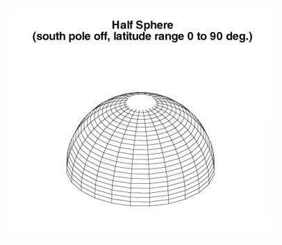

imagine the half sphere is a permanent magnet , could it be formed so that it's one pole is in the inside while the other is on the outside and what would happen if I placed two such half sphere close together in a way that would normally resemble a sphere only with a slight gap between them ? Would there be a monopole like magnetic field inside the volume enclosed by the half spheres ? Would the field lines come out through that small gap between them to form loops and if I would close the gap by putting these two magnetized half spheres the field would vanish right ?Because there would be no loops anymore
now imagine the same situation with the two magnetized or permanent magnet half spheres only this time the gap between them would be closed with a bismuth circle , in other words the two half spheres physically put together with a bismuth connection , what would happen then ? Bismuth is the best natural diamagnetic as I read , aka it expels b field lines so if I have two same polarity poles facing inwards but not touching each other magnetically or physically what would ahppen in such a situation ? Yes Jtbell I guess I am thinking about something similar to the paper you sourced
The fields would cancel nearly completely (and completely if you close the gap).
Right.
The reaction of all conventional diamagnetic materials to magnetic fields is quite weak.
You can use superconductors, they are perfect diamagnetic materials. Then you'll see a higher field strength close to the borders of those superconductors.
