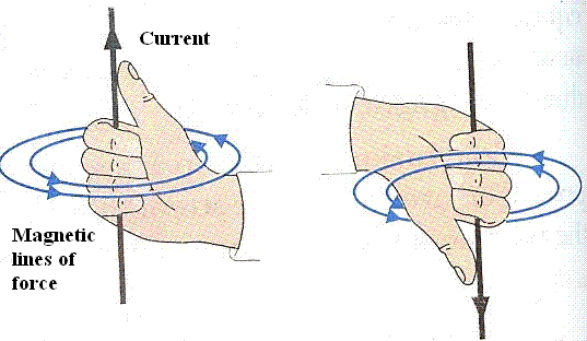

according to RHR , the curled fingers show the direction of magnetic field or flux & the thumb gives the direction of current.. but I am confused about the curling of fingers.. I want to make my doubt clear by the pictures I attached..
In bothe first & second picture , the magnetic field is in downward direction irrespective of direction of current..
but if we keep the hand in another way as in third , the direction of current is towards left but magnetic field is in upward direction..so which are correct way to find out the direction this thing is making me confused..! Please help.

I'have already gone through that article but that's not answer to my query..! Please read the question once again.. In both the the 2nd & 3rd picture , current is towards left but by changing the hand posture , magnetic field direction is being changed.. then which is the correct one?
Look in the direction of the current vector and you'll see that the magnetic field direction is "circulating" clockwise in both cases. See your annotated attachments. Note that I only flipped the first image to get the second image.

so what should I infer from this..?? My doubt is still not clear... in 2nd & 3rd both pictures the direction of current is same but the direction of magnetic field is different so which one is wrong among 2nd & 3rd..how should we curl the fingers then..?? Are both right..??
ranju said:
... the direction of magnetic field is different ...
No. They are both in the clockwise direction, relative to the direction of current.
ohkk so magnetic field is clockwise relative to current but how do we know whether it is in upward or downward..??
The guy's using the same hand in all three pictures so it just has to be consistent. You may be having a problem with the 'spatial relationship' thing. It can't work differently, depending how he positions his hand, can it? Same fingers and same thumb must work for all orientations. Do it with your own hand and see how there's no change.
The direction of the field is not 'up or down'. The magnetic field lines follow a circle, which has up. down. left and right at some point.
BTW, I would call this rule the Corkscrew rule (Cork screws are all right hand thread). Fleming's Right Hand Rule tells you the direction of induced current when a conductor is moved through a magnetic field. It has a partner rule (the Left Hand rule) - for the Motor effect.

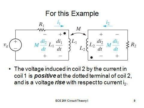

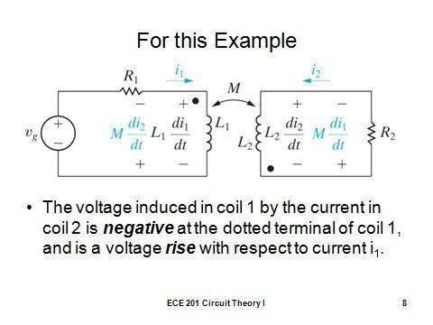

In this url.. many things are clear to me which I did'nt discussed about.. thanks for that.. but I am doubtful regarding the polarity ..in bothe loops of attached fig. current is approaching the dot so mutual inductance must be positive.. but in the equations given by gneil.. he took M as negative..!
why..??
sorry , in the first equ. He took +M only.. so is'nt it right that mutual inductance will be positive for the 2nd loop too..??
Here are two images from a "www.faculty.umassd.edu/xtras/catls/resources/binarydoc/4598.ppt" that nicely shows how the dot convention is used with the mesh-current method.

According to this ppt.. when current enters the dotted terminal , the voltage induced is positive at dotted terminal..but in the attached fig.. it is negative at the dotted terminal.!
sophiecentaur;4855857} And what has the next part of the thread got to do with this particular problem? Why not sort out one thing at a time and then use another thread to discuss induction between coupled coils?[/QUOTE said:
I'hv discussed that thing with my teacher and its clear now after your points ..that there's something wrong with the article .. and you all were right ..! thank ou all for helping out..
