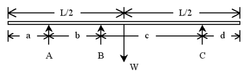

Basically, you have a rod kept horizontally on three supports. It's in equilibrium. The positions of the supports and the mass and length of the rod are given. Find the normal force by each support.
The problem looks particularly simple. But notice that you have a shortage of an equation. You have three things to find - the three normal forces. And you have only two equations - one for translational equilibrium of the rod and one for the rotational equilibrium. So what's the problem?

Here is a diagram, and a calculation based on that diagram showing that the torque equations are not independent. Forces A, B, and C act upwards and their sum must be the weight of the rod. a, b, c, and d are the distances between the five points locating the ends of the rod and the supports. The two torque equations are calculated about the ends of the rod, but you can use any points you like to generate as many equations as you want. Add your torque equations together and see what happens.
[tex]A + B + C = W[/tex]
[tex]aA + \left( {a + b} \right)B + \left( {a + b + c} \right)C = W\frac{L}{2}[/tex]
[tex]\left( {b + c + d} \right)A + \left( {c + d} \right)B + dC = W\frac{L}{2}[/tex]
Add the last two equations
[tex]\left( {a + b + c + d} \right)A \ \ +\ \ \left( {a + b + c + d} \right)B \ \ +\ \ \left( {a + b + c + d} \right)C = WL[/tex]
[tex]\left( {a + b + c + d} \right)\left( {A + B + C} \right) = LW[/tex]
Divide by the first equation
[tex]a + b + c + d = L[/tex]
This is just an identity. There are only two independent equations. The only additional restriction is that none of the three forces can be negative, assuming the rod is merely resting on the supports and not attached.

ill try solving it taking torque eqns @ the supports later but if u say it can't be solved, why can't it!? its a unique system isn't it?
No, it is not unique. Consider the diagram, and suppose you require the forces A and B to be equal. Then the solution would be unique. Given that solution, suppose you now gradually reduce B while increasing A to maintain equilibrium until B reaches zero. Then gradually increase B while decreasing A to maintain equilibrium until A reaches zero. All you can do for the given set of positions is come up with the relationship between A and B that must be satisfied. The range of possible values of A and B will be bounded (assuming both must be upward), but the values are not unique.
