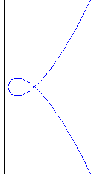

using that I and all the problem info, I had maple do a DEplot
of the solution of the ODE system.
The attachment shows the graph from t=0.18 to 0.20 seconds.

I'm curious about the full trajectory of your solution. Initially I thought the path might be parabolic, but the possibility of a second solution makes me think otherwise. With a force that is always perpendicular to the velocity, diminshing as the distance from the wire increases, I don't see any possibility of multiple approaches to the wire, but I suspect that the y component of the velocity can retrograde one time for an approach, something along the lines of this diagram. Does something like this fit the solution?

yeah, i think the solutions are more loopy than parabolic,
which makes sense. it's easier just to play around with
the DE system using a nice numerical solve/plot package.
changing conditions from the original problem to
vx_0 = -3*cos(Pi/4)
vy_0 = 3*cos(Pi/4)
x_0 = 0.5
y_0 = 0
I = 1e-4 gives the first graph (t=0..3)
[inverting the equation for I = f(x_c) i plotted x_c given
the I, it's the red vertical line.]
and I = -1e-4 gives the second graph (t=0..1)
[this is weird, the two solutions for x_c are plotted,
but the negative solution gives nothing, and the positive
solution gives the farthest point. I'm not really sure
what's happened here. ]
notice the loops are tighter for a current down the wire
and the direction of motion changes.
if we go with a positive current (which is the only
one i trust.) and increase it. the solutions become
more and more circle like. this makes sense because
the field is better and better approximated by a const
linear field.
the third drawing is for i = 1amp. t = 0..0.001 (or something,
i forgot to write the time down before i exported it.)
I don't have any tools handy to do numerical solutions. Apparently I was wrong about the electron not making multiple passes near the wire. It makes sense now that I think about it again. All that is required is that the radius of curvature be proportional to the distance from the wire. Your diagrams appear to have a smaller radius at the maximum distance than at some closer point, but I'm quite sure that is just a scaling issue. Any chance you could draw those so that the axes are to the same scale to better represent the shape of the trajectories?
