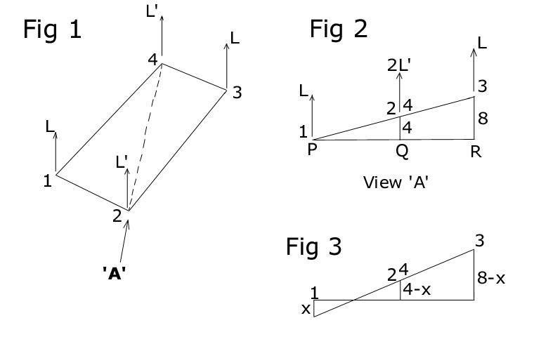

Problem 2
The suspension springs of all four wheels of a car are
identical. By how much does the body of a car
(considered rigid) rise above each of the wheels when
its right front wheel is parked on an 8-cm-high
pavement? Does the result change when the car is
parked with both right wheels on the pavement? Does
the result depend on the number and positions of the
people sitting in the car?

I found this one a bit awkward to visualise at first.
I've got a solution but I'm not sure if it's right - what do you think?
Here's my case for how I solved it.
See attachment
Argument
If car is raised at spring 3, then the two springs 2 and 4 are also raised/extended.
Since 2 and 4 are extended then the compressive load from these springs, supporting the car, is reduced.
.: Additional load is required from springs 1 and 3 to support the car.
By symmetry, springs 1 and 3 are equally compressed, by an amount x, say. And the springs 2 and 4 are equally extended, also by an amount x.
I was able to get x = 2.
i.e. springs 1 and 3 are compressed by 2 cm - car body lowers by 2 cm above the wheels
springs 2 and 4 are extended by 2 cm - car body rises by 2 cm above the wheels.
If both right wheels are on the pavement, then all springs ae giving the same load/support, so the car body won't rise/lower wrt the wheels.
All results are indepndent of the numbers of passengers or their positions provided they represent a UDL. (uniformly distribiuted load).
I agree with this part
I tried to find X : elastic potential energy EPE of the 2 compressed spring = EPE of the 2 extented ones + the GPE gained by the centre of mass of the car
But if the springs are compressed and extended by X equally, they woulf cancel out.
I am stuck at this part. :frown:
I just drew a diagram! Of the springs and car (modelled as a UDL board) see attachment in post #14.
If you think about it ...
Suppose springs 1 and 3 are rigid. Now lift up spring 3 by 8 cm. Springs 2 and 4 are half-way across the car, so will lift up by 4 cm - i.e. 2 and 4 get an extension of 4 cm. Spring 1, being rigid, does not change.
Now let springs 1 and 3 be normal springs again. They will both compress by 2 cm. The top of springs 2 and 4, being attached to the car/board will also lower by 2 cm. But they had been extended by 4 cm. So, in effect, they get an extension of 4 - 2 = 2 cm.
This agrees with the Argument. That springs 1 and 3 compress by an amount x = 2, and springs 2 and 4 extend by an amount x = 2.
I'm not sure how you would do it this way. We don't know what the spring constants are. I don't think you can use the mass of the car for GPE since we don't know the position of the com of the car. And the lift given to it would vary depending on the geometry of the car - which we don't know.
As I said, I just drew a few diagrams - see following post.
In Fig 1, I have modeled the car as a board, representiong a UDL, un-equally supported at the four corners.
Take a view-point along the diagonal from spring 2 to spring 4.
This gives View 'A', Fig 2, where springs 2 and 4 overlap and are equi-distant from springs 1 and 3.
The line PQR is the top of spring 1. Assume springs 1 and 3 are rigid.
Spring 3 is 8 cm above the road - this will give an extension of 4 cm in springs 2 and 4.
Now let springs 1 and 3 be normal springs. The whole car/board will lower by the same amount, x cm say. See Fig 3.
Spring 1 is compressed and goes x cm below the base line/level PQR.
Springs 2 and 4 are lowered by x cm, such that they are now (4-x) cm above the base line, i.e. they have an extension of (4-x) cm.
But by the Argument, this extension is x cm.
.: 4 - x cm = x cm
4 = 2x
x = 2 cm

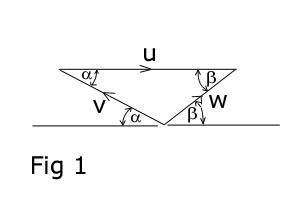

i) this part is easy. Draw the velocity vector diagram such that the resultant vcelocity of the boat is directly across the river, perpindicular to the flow of water.
ii) Look at Fig 1. The boat travels, at velocity u, at an angle α to the river bank and the resultant velocity, w, is at an angle β to the river bank.
The cross-river velocity is wsinβ. Time to cross the river is T = L/wsinβ, where L is the width of the river.
Distance traveled by boat is S = wT.
S = w*L/wsinβ
S = L/sinβ
S is a minimum when sinβ, or β, is a maximum.
β is a max. when the angle between v and w is 90º. You would have to prove this. There are a couple of ways of doing that.
The vector triangle is now a right-angled triangle with u = 4 and v = 3 and w = √7.
sinα = w/u = √7/4
α = 41.41º
