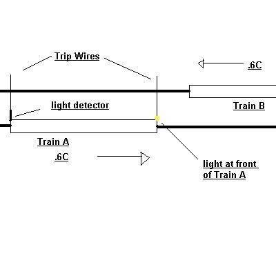

Train A is traveling at 60% the speed of light going East. Train B is approaching Train A while also traveling at 60% the speed of light going West. Train A is equipped with a trip wire at the front and a trip-wire at the back and also a light at the front of the train and a light detection device at the back. When the front of Train A meets the plane of the front of Train B, the first trip wire sets of the light at the front of train A. The question is, will Train B make it to the rear of train A before the light?

here is a crude diagram of my question
see attachment

Firstly I assume you mean from the refernce point of train A (though this won't affect the answer qualitvely). The answer is no the light will always reach there first as in special relativity the velocites do not sum in the same way they do in Galliean relatvity, but obey the formula v' = (u + v)/(1 + uv/c2), so, from the point of view of train A, train B will be traveling at about 88% of the speed of light and (by symmetry) vice versa.

Now, for the full force of my ignorance. "u" represents what? And which velocity does "v'" and "v" represent?

In this case u represents the velocity of Train A from the refernce point of the track, v the velocity of Train B from the refernce point of the track and v' the velocity of Arain B from the reference point of Train A

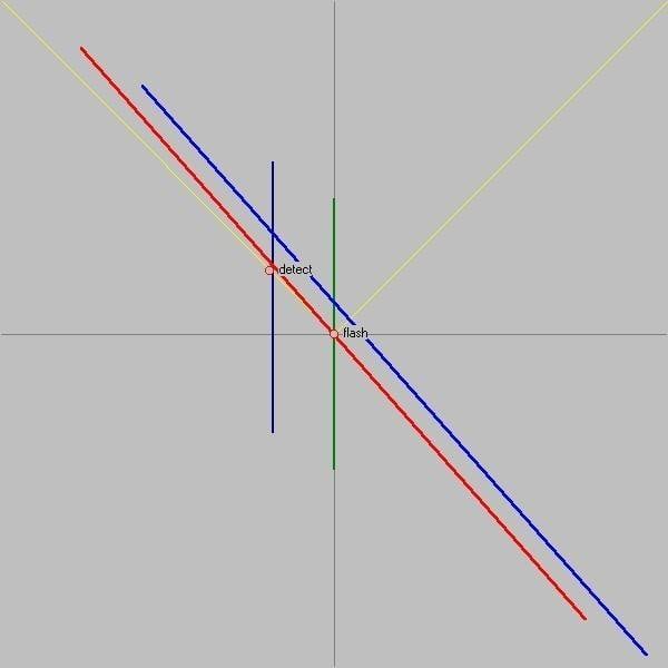

As already answered, yes, the light will arrive at the detector before Train B. Here's a spacetime diagram showing the result diagrammatically from the rest frame of Train A.
