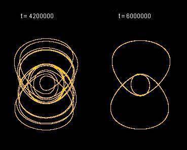

Sorry for my response has been delaying. Oh, that's a nice drawing for that limit cycle! By the way I've been continuing to find any other limit cycle in this dynamical system. And I found it at last! Strange enough, the parameters for that limit cycle are exactly same as the previous ones, i.e.
a = 0.2
b = 4
c = 0.1
d = 0.1
Using those parameters, I got the limit cycle shown in the right side of the attached file after 6 million iteration. As the reference, I put in the left side the trajectory after 4.2 million iteration. Namely that limit cycle is a very weak attractor. (Exactly saying, that limit cycle should be called a tube because it has a finite sectional area, although it is very small.)
I updated my webpage to explain those things as,
http://www.geocities.com/tontokohirorin/mathematics/limitcycle/limitcycle2.htm
Also I showed in that webpage the Feigenbaum Plot you've obtained. If you feel it is inappropriate, please let me know. I'll withdraw it from the webpage immediately.
