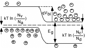

here I found this diagram, see attachment, so that I can put my question in a clear way.
this is a pn-junction, on both sides is the same material but different doping, p and n, so before we bring them in contact only the fermi levels are different but the energy levels are equal. after the contact, the fermi levels get aligned and we get a band bending.
now the question is, we see in the diagram that the energy levels far from the contact are not equal, and this is what's making my confusion.
They are not equal to what ? You mean to each other ? This cannot be the case since the energy bands of a p-SC are not at the same position with respect to the Fermi level as those of a n-type SC.
