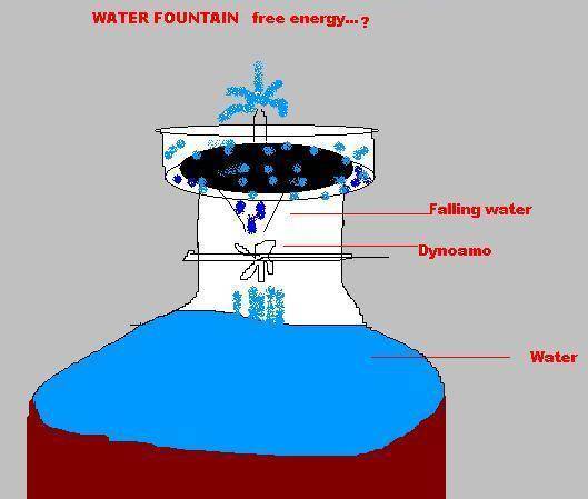

Guys,
I hope you know the principal of WATER-FOUNTAIN (like the one you see in park etc... that don't need much additional mantinance or EXTERNAL energy to operate)
See the pic (attached.)
If the water in top bucket is made to fall directly on the top of the blades of (small)dynamo. Hydro-electricity will generate. So,(say) if this mechanism is put in a closed environment & made in a way the water discharge/sec through the fountain head EQUALS the rate falling water over the dynamo blade...
(Theoritically) isn't it possible to tap out electricity for infinite amount of time?I don't seen a bug in this process... (help me figure out)
free energy?
-bipin

You DO realize energy is needed to lift the water from a lower level to a higher level, right? You must do work to increase its potential energy.
This energy is converted to kinetic energy when the water falls down. If you put a dynamo you can convert some of that kinetic energy to electric energy, but not more than the kinetic energy the water had in the first place.
If you would build a PERFECT (doesn't exist) machine to convert all the kinetic energy of the water drops falling down to whatever energy, the best you could do is keep the fountain running (use that energy to lift the water back up the fountain).
Free energy? No.
Here's the bug: what lifts the water back up? The same energy that hydro-energy it creates. NOt only that, friction will take some of that energy away, so the system will not even maintain a steady, unchanging flow. In no way will more energy come out.
This is the same perpetual motion idea that comes up once a week for the past 700 years.

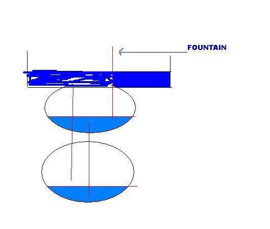

you guys DON'T get me... you know how water fountain work. do you? I'm not talking about the ONE that uses pumps to keep the water flowing... I'm talking about the one... (let me think... how can i explain) mmm... i didn't even got a pic on internet....
I forgot the exact PIC. but see the atachment... (SOMETHING like that) & that's a automatic process...
the red lines are the pipes connecting the two "air-tight" chambers... & the fountain operate due to the pressure difference created...
(something like that... i forgot the actual fountain MECHANISM/DIAGRAM...)
haven't any of you guys seen that mechanism... huh!

In answer to your proposed setup v2.0:
The fountain will run until the water has fallen to its lowest level. And then it will stop.

As dave already said, yes we get you. Here's the deal: a bunch of people who have degrees in Physics and engineering are telling you this can't work for "free energy." We can see exactly what you are talking about and we each could tell you in detail why this can't work.
But instead of saying that we don't get it, try thinking, for a moment, that maybe such a simple idea for "free energy" would have been invented and put to use by now?
I'm not an expert in water fountains, but the only way you could keep a water fountain flowing without an external input of energy is if you were somehow using sunlight to drive it. Perhaps the water fountains you have seen use sunlight to heat the water or a gas and create a pressure differential. As has been said above, the ONLY way to get water from a lower level to a higher level is to give it more energy, and that energy HAS to come from somewhere. Any water fountain that does not have an external source of energy will stop flowing eventually. In reality, every fountain you have come across will have some source of energy, even if it is just the pressure in the water pipes supplying the water.
If you were using the sun to power your fountain, then in a perfect system the electrical energy you could generate would be exactly equal to the solar energy being absorbed by the fountain, in which case it would probably just be easier to use solar panels.

in your second device, you are basically taking the idea with the water wheel and that one tube made by that famous greek mathmatician whose name i always forget and putting it together but with tubes instead of a water wheel. the pull of gravity on the tube that takes the water down would be about equal to the pull on what takes the water up, so it would all come to a standstill

It looks like the pic is a version of a Hero's (Heron of Alexandria) fountain. The principle is having an open chamber with two openings. Fill the chamber with water, the water flows through a tube to a lower, airtight vessel, creating air pressure in that vessel. The air pressure is transferred to another, higher airtight vessel filled with water which, in turn, pushes water downward through another tube that goes up to the original chamber through a spout, that in turn fills that chamber which flows to the bottom airtight vessel. Not perpetual because eventually, the water in the one vessel ends up in the other. You can only push air from the lowest vessel to the middle vessel, not water. But I think his thought is if there were an electric generator on the top fountain, could you pump the water when the level gets low. Or at least something along those lines. I built one myself (without a generator) and it is a very fun and amusing thing. I found a blog that showed me how to do it here. http://astroshack.blogspot.com/2006/09/im-holdin-out-for-hero.html.
Hope this helps...
