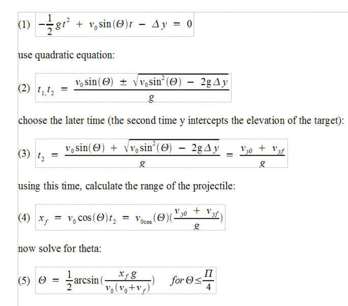

I was told by a professor that there was no analytic solution (it's a numerical methods course) when there is a elevated target. However, I can't find anything wrong with the analytic solution I came up with. Would anyone mind confirming that my formula (attached gif) for the launch angle when the initial velocity, range, target altitude are known is correct?
In addition, I understand that there are two angles for hitting the same target. One is the theta in the attached formula, the other is: PI/2 - THETA. I just don't know how to show this mathmatically. Any pointers? Is there something I am missing with the arcsin of a double angle?
Thanks in advance,
Matt
This is true only if [itex]x < x_{max}[/itex]. Using two equations of motion for a projectile [itex]y(\theta,t)[/itex] and [itex]x(\theta,t)[/itex]. You you can combine them to eliminate t, resulting in [itex]y(\theta,x)[/itex]. Solving this for [itex]\theta[/itex] will result in 2 values.
Actually, I'd be willing to bet that if [itex]x = x_{max}[/itex] the solution is two identical roots, [itex]\frac{\pi}{4}[/itex].
Re the first item, I didn't check your math, but there is no reason an analytical solution isn't possible for an elevated target. In fact, my Intro Dynamics book has a problem solution for kicking a football for a field goal, the goal post cross bar being an elevated target.

I believe this is what I did in the attachment. Is it not? Yet, I only got one value... Not sure what I am missing.
Sorry it isn't in TEX. I did it in OpenOffice.org which is almost not completely TEX-like.
I have to agree with hotvette, it's certainly possible find an analytic solution. This is basic intro physics parabolic motion. Perhaps the professor was including air resistance? I don't know what he/she could have meant otherwise.
Re two angles, I thought you were asking in general as opposed to an elevated target. The approach I mentioned works for a non-elevated target, but I'm not sure about elevated target. Hmmm, I need to think and reason a little.
A couple of things seem strange in what you did. In (3), you eliminate [itex]\theta[/itex] from the equation only to use it later in (4) to solve for [itex]\theta[/itex]. It may be valid, I've just never seen a derivation like this before, especially having it in terms of [itex]v_{yf}[/itex]. Secondly, in (3), you choose to use only the 2nd solution.
Think of this. Take (4) and solve for t. Substitute this result into (1). Thus, you'll end up with a quatratic equation in theta. If you know x & y, there should be two solutions for theta. The only catch is the x,y position of the target must lie inside the trajectory at [itex]\theta = \frac{\pi}{4}[/itex]. Otherwise, there is only 1 solution or no solution.
I may see the numerical analysis part. If you do as I suggest, you end up with an equation with terms like [itex](cos\theta)^2[/itex] and [itex]tan\theta[/itex]. This may not be solveable analytically for aribtrary x & y.
Another thing I noticed. Your solution has a [itex]v_f[/itex] term in it. In reality, [itex]v_f[/itex] is a function of [itex]\theta[/itex]. Think about it.

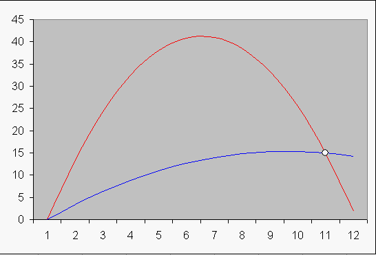

OK, finally got it. It was right in front of my eyes all along and I didn't see it. If you combine the equations for x(t) and y(t) into one equation to eliminate t, you get something that looks like:
[tex]y = \frac{a}{cos^2 \theta} \ + \ b \ tan \theta \ \Longleftrightarrow \ y = a \ sec^2 \theta \ + \ b \ tan \theta[/tex]
Using the trig identity [itex]sec^2 = tan^2 + 1[/itex] you end up with an equation in [itex]tan \theta[/itex] and [itex]tan^2 \theta[/itex], which is a quadratic equation in [itex]tan \theta[/itex] that can be readily solved. Attached thumbnail illustrates the solution for specific values of [itex]x, y, v_0[/itex] that I chose.
The challenge question is to find the equation of the curve that bounds the valid values of x,y.
EDIT: I now follow what you did, and why you picked the second t. Everything you did was valid except getting from (4) to (5). First, there is a math mistake, plus you solve for [itex]\theta[/itex] in terms of something that is a function of [itex]\theta[/itex]. If you go from (3) to (4) w/o the last simplifying step in (3), you'll get an equation in [itex]sin \theta[/itex], [itex]cos \theta[/itex], and [itex]\sqrt{asin^2 \theta \ - \ b}[/itex]. Solving this for [itex]\theta[/itex] (looks complicated) should yield the same answer as the approach I took. All you did was solve for t first, then substitute, whereas I substituted to eliminate t, then solve for [itex]\theta[/itex]. Both should yield the same result.
