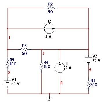

How Would I Work Out The Solution Given That There Are Current Sources In This Circuit.. And TO CALC The Power Dissapated In The R3 Resistor.
Regards
This circuit just cries out to make some Thevenin/Norton transformations. You could transform the two current sources (plus their associated parallel resistors) into Thevenin equivalents and then do a loop analysis, or you could transform the two voltage sources (plus their series resistors) into Norton current source equivalents and do a nodal analysis.
Try one of those and post your results. If you're still having trouble, then I'll follow up.
