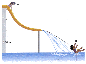

"If the height of the water slide is h = 3.2m and the person's initial speed at point A (at the top of slide) is 0.54m/s, at what location does the swimmer splash down in the pool?"
I need help with this guys. It may be relatively easy, but I'm not seeing it. I don't know what formula to apply here. I have an initial velocity and a height of the slide. Thanks in advance.

This is a picture of the problem I'm having difficulty with. Thanks!

Ok now with the picture is clearer, just find the speed at 1.5 m through conservation of energy and then work it out with kinematics (uniform acceleration neglecting air drag)
The "projectile" is launched from 1.5m above the pool,
with a horizontal velocity.
After getting the horizontal speed, you have to find the time that it takes to fall 1.5m (h=(g*t^2)/2) then you find the horizontal distance that the kid went by x=vt.
Would I use the formula v=square root of 2gh to figure out v2?
