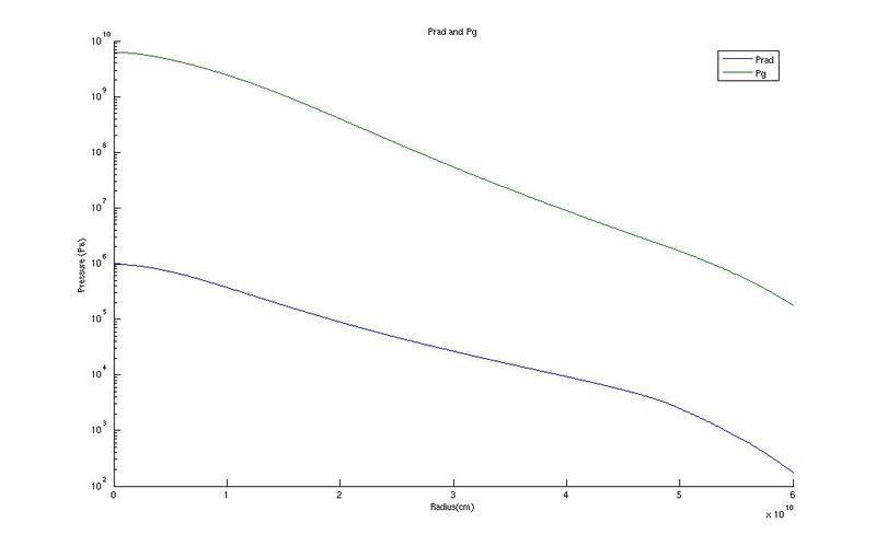

  • #33
rocketman7 said:
stars are in a state of hydrostatic equallibrium. outward radiative pressure from photons and nuetrinos emitted in he core are balanced by the inward force of gravity.:smile:
While this is technically true, as SpaceTiger pointed out, radiation pressure is insignificant in the case of the sun.
I whipped this up in Matlab real quick to demonstrate. The graph is on a log scale, so the [tex]10^#[/tex] you see on the y-axis is the same as that part in scientific notation. it had to be log scale for the gas pressure to even be noticeable on the graph. A difference of 10^4 is a factor of 10,000 difference between the two.
