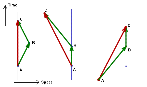

It is easy to account for the asymmetry. Have a look at the attached space time diagrams. The first is the point of view of an observer that stays in the Earth frame. (The stay at home twin that remains on the Earth only goes forward in time as represented by the red line A,C.) The second is the point of view of an observer that is at rest with the frame that represents the outward journey of the traveling twin (The green line labelled A,B). The third is the point of view of an observer that remains at rest in the frame that represents the traveling twin's return journey (The green line labelled B,C). In every case every observer measures the traveling twin's path through spacetime (path A,B,C) to be longer than the stay at home twins path through spacetime (path A,C). When looked at from the spacetime path point of view there is no symmetry.

Kev, your diagram is very helpful. In others words a straight line is the shortest path between two points. The clock/observer who never alters their path direction in spacetime will have the shortest path length. The clock/observer who takes a turn in their spacetime path will have a longer path. I think this is the whole story of the twins.
But I still think we need better wording (maybe more careful wording) to talk about "time".
Kev, in your first diagram you show time in the Earth frame only. That is at the start before takeoff when they are both in the same inertial frame they both see 0 years on the Earth clock. And when the ship returns from its round trip and stops they both see 20 years on the Earth clock. And they both see 2 years (assuming gamma of 10) on the ship clock. To say that the ship board observer went only 2 years in time but ended up at the 20 year mark by the Earth clock needs some careful wording. It gives the appearance that things went slower on the ship?
It is almost like the traveler has a complex time vector with a "real" part and an "imaginary" part. Where the total time vector length is 20 in the Earth frame (and all real) but the real component is 2 in the ship frame and the orthogonal part (imaginary) is 19.899 in the ship frame. and physical aging only takes place with movement along real time axis. I guess I would have to say the real time axis in the moving frame does not point in the same direction as the real time axis in the Earth frame. I have no idea what that statement means "the real time in frame1 points in a different direction than real time in frame2".(?) Is there always a local (frame) time and when you transform the local (frame) time to another frame you get a real and imaginary part in the other frames point of view? That is Earth sees 20 years of time vector for itself and 2 years of traveler time vector that projects on the real time in the Earth frame and 19.899 that projects on the imaginary time axis. Help I am lost...
