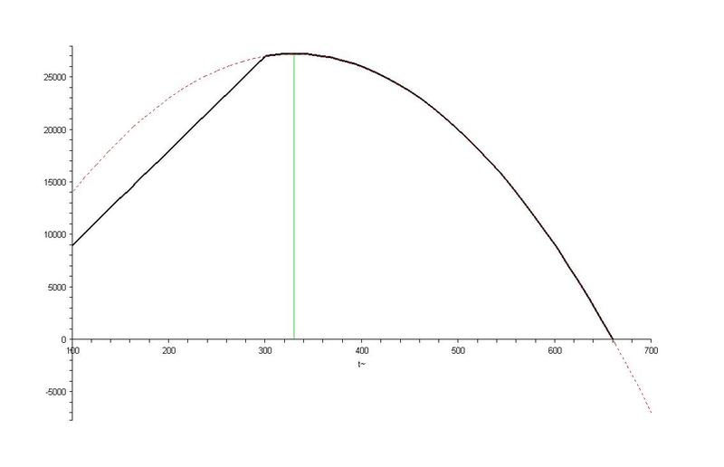

Here is a plot of C(t) I did with maple...

If, for every table over 300 the price per table decrases by $0.25, then after [tex]\frac{90}{0.25}=360[/tex] such discounts the tables are free, this occurs for a purchase of 300 + 360 = 660 tables are purchased, 300 to qualify for the discount, 360 more to reduce the price per table to nothing.
The rest of the plot is revealing.
