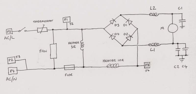

Are the two circuits attached the same? "Circuit diagram" is the original schematic file, and "circuit" is the one I tried creating online. Are they the same?
I am doubtful of the overlapping of the wires and also the power sources.
Thanks so much!

No. I'm afraid there are lots of differences/issues some of which can't be resolved without additional information.
If you are trying to build a 9V DC circuit it might be easier not to start with one designed for 230V AC.
Tell us what you are trying to achieve.
Several issues here. You have to beware about doing very neat presentations of the wrong information. You can fool people that it's kosher!
At one time,, crossing wires used to be shown as a 'humped bridge' but circuits involving many wires, close together would have been too messy. So the convention, now (afaik) is to assume wires are not soldered together unless there is a joining 'blob' to signifiy a join. But I don't think 'humps' are actually forbidden.
The "batteries" are clearly not batteries - P5 and P4 (or P3?) are the mains live and neutral connections (possibly they are Pins (P for Pin?). P1 and P2 take the mains further on in the unit (to a lamp?).
The thermostat symbol is one I'm not familiar with; it looks a bit like a Thermistor. If in doubt, I would use a box with "thermostat" in it. The same applies for the Fan.
Resistors are usually denoted by rectangles and not zigzags in ISO, afaik.
There are some commonly used symbols on this link.

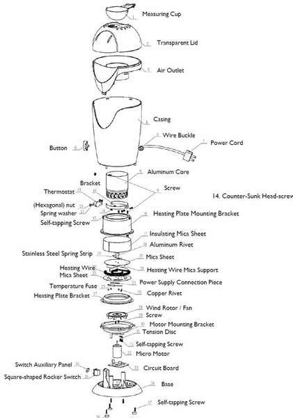

Here is what the circuit is for - an appliance.
The batteries/source is wrong. It has to be a power cord from the wall going through the unit (see diagram attached with this response). How do I show this in the circuit? I put the batteries because I didn't know what else to put.
Also are the four diodes supposed to be a AC-DC rectifier?
Just copy the original circuit. For example next to terminal P5 it says "AC/L" which stands for "AC - Live".
Do check the spec for the 1n4148. It's been awhile but I think the voltage rating (and possibly other parameters) make it unsuitable for mains voltage applications.
Ok, so what do the P's actually look like in real life? The wire connections?
Yes.
It looks like P3 should be connected to AC/N via another switch or switching device. This device would then controls the motor and the 10ohm heater.
EDIT: Ignore the above.
I see that the motor is in series with the 10 Ohm heater...eg the circuit is...
AC Live -> themostat -> Bridge rec -> motor -> P3 -> 10 ohm heater -> fuse -> AC/N
So P3 could just be a test point.

Yes. It's a bridge rectifier arrangement. I am a bit concerned that, with your limited level of knowledge, you want to get involved with a piece of mains equipment. Even if you don't plan to get inside it yourself, the information you are transcribing will presumably be used by someone else. If they are capable then the original diagram would be quite enough.

In my opinion the overall layout of the original circuit is quite poor. Could be drawn a lot better to make the flow easier to follow. For example left to right I would show...
The AC Live and Neutral inputs
The switch and fuse
The Thermostat
The bridge rectifier
The coils
The motor and caps
Would it be too much to ask if I kindly requested you to draw it out somehow? Thanks sooo much!
Sorry it's only a sketch, I'm a bit short of time. I've used roughly the same symbols the original used.
The capacitor values are missing off the original. Do you know what type they are? If they are polarised electrolytic then a different symbol should be used.
I haven't really checked for mistakes. I see I forgot the fuse type/rating info.
It's possible to argue about some of the details. I'm not claiming drawing conforms to any ISO standards or anything like that.

It looks great! I don't know how much the L and C values are, but I'd like to thank you for your help in the matter!
