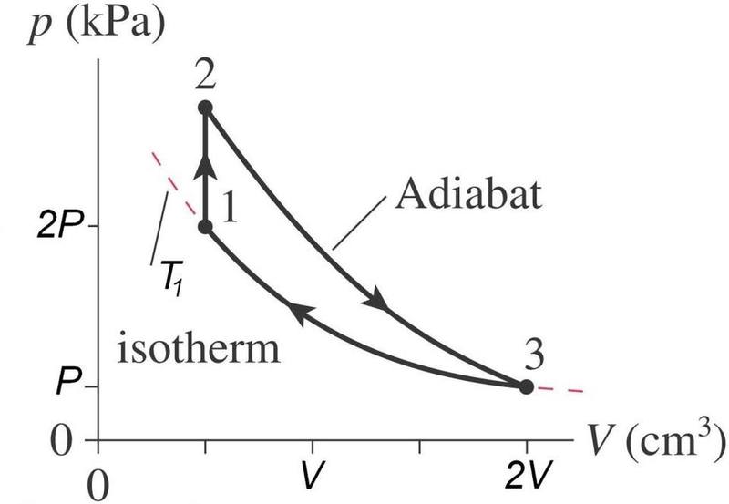

A heat engine uses a diatomic gas that follows the pV cycle shown in Figure.
Part 2→3 is adiabat, part 3→1 is isotherm, V=1040 cm3, P=100 kPa, T1=212 K.
Determine the pressure at point 2.
Determine the volume at point 2.
Determine the temperature at point 2.

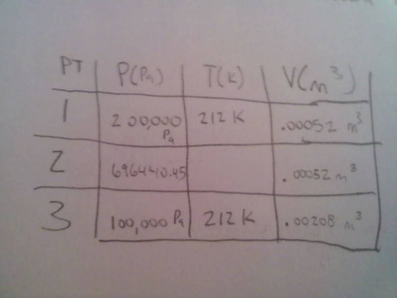

I know how to do the rest if I can find the temperature at point 2. I tried 2 different ways.
1. I tried using the Ideal Gas law PV=nRT and solved for mols at pt 1. Then tried using that for point 2 and then used PV=nRT but that didn't work.
2. Then I tried just simply using PV/T=PV/T and came up with the same answer and they are both wrong.
What am I doing wrong?

It looks like there is a typo here. We know pv=constant for an isotherm, yet we have pv=2PV at 1, and pv=PV at 3. I suspect it should be p=0.5P at 3, judging from the scale of the p-axis.
For the adiabat, a useful equation is
pvγ = constant​
(Look up γ[/SUP] for an ideal diatomic gas in your textbook, if you're not sure what it is.)
I understand what that symbol means for monatomic its 5/3 and for diatomic its 7/5. But for the W for 2-->3 I tried using the following...
W=nCv(delta T)
n-mols Cv-constant volume Delta T- Change in temp.
W=(.118 mol)(5/2)(8.31)(369.1-212)=138
I get a different number of moles than you did, calculated using p, v, and T at point 1. Perhaps you should reproduce that calculation.
I agree with the 369 K temperature at point 3.
