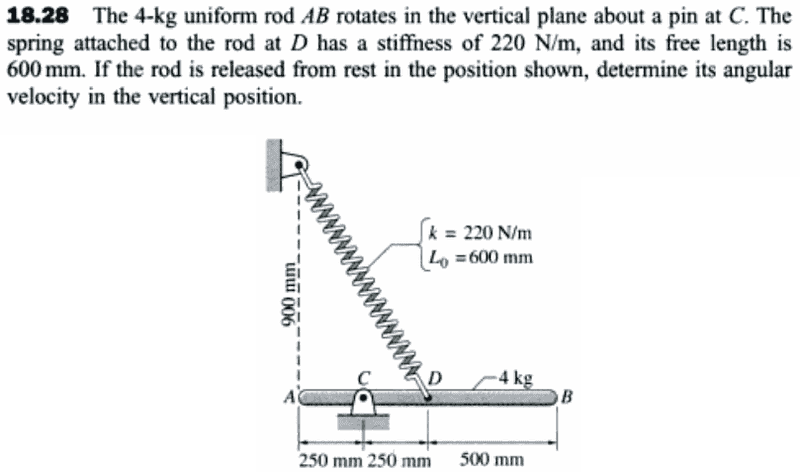

I found a similar problem with a confirmed answer.
The answer is ω=19.04 rads/s.
Whenever I work this one out though, I can't get that.
Initial length = sqrt(.9^2+.5^2) = 1.029563 m
Initial stretch = 1.029563 - .6 = .42956 m
Final length = sqrt((.9-.25)^2+.25^2) = 0.6964194 m
Final stretch = 0.6964194 - .6 = 0.0964194 m
Initial elastic PE = .5*k*x^2 = .5*220*.42956^2 = 20.2974 N*m
Final elastic PE = .5*k*x^2 = .5*220*0.0964194^2 = 1.022637 N*m
Final grav. PE = m*g*h = 4*9.81*.25 = 9.81 N*m
Final rotate PE = .5*I*ω^2
= .5*((1/12)*m*l^2 + mr^2)*ω^2
= .5*[(1/12)*4*1^2 + 4*.25^2]*ω^2
= .5*.58333*ω^2
Initial = Final
20.2974 = 1.022637 + 9.81 + .5*.58333*ω^2
ω = 5.69656 rad/s
This is not equal to the book-provided answer of 19.04 rads/s. I don't know where I'm messing up.

Would you mind checking over my calculations for the alternate problem I posted? I can't seem to get the supposed correct answer (according to the book). The problem's in SI units :)
Have you got the moment of inertia right? I worked it out as follows..
The moment of inertia about the end of a rod is
(1/3)ml2
http://hyperphysics.phy-astr.gsu.edu/hbase/mi2.html
You have two rods of mass m/4 and 3m/4 and lenghts L/4 and 3L/4 so..
I = Ileft + Iright
I = (1/3)(m/4)(L/4)2 + (1/3)(3m/4)(3L/4)2
= (m/12) L2/16 + (3m/12) 9L2/16
= (m/192) L2 + (27m/192) L2
= (28m/192) L2
(1/3)ml2
I = Ileft + Iright
= (28m/192) L2
(28m/192) L2 resolves out to .58333 when m=4kg and L=1m are inputted. .58333 is the same as my calculations for I.
Doesn't look like moment of inertia is the problem. =/
I suppose the book-provided solution could be incorrect...
