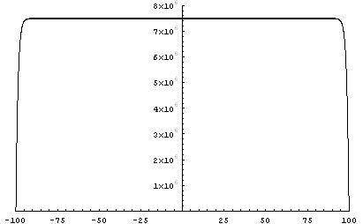

Hi all,
I am more into physics than maths and I need you guys to please help me out. Also I am new to programming in MATLAB. I have done some but still I consider myself a novice. I need to solve the problem in MATLAB.
So here is the problem.Its a 2 point BVP(boundary value problem) along a straight line ,say along x-axis , from -L to +L.
A*N''=B+(C*N)+(D*N^2)+f(N)
[prime denotes differentiation w.r.t x, N~N(x) , f(N) is a simple function of N, say log(N), All constants are known]
Now I need to solve this BVP for the following boundary conditions:N(-L)=B1 and N(L)=B2, Both B1 and B2 are also known.
The problem is that this particular equation needs to be solved using the "Relaxation Method" and Runge-Kutta/ Shooting method's are not considered suitable traditionally for this diffusion like problem.
Can anybody suggest me a code for this problem in Matlab. I haven't seen any function in MATLAB capable of solving NL BVP.
Please help.
JAM

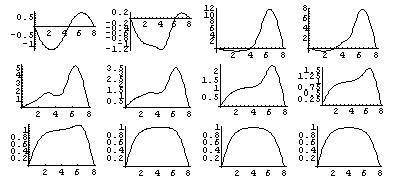

I think the idea you have in mind is
N''=f(N) N(-L)=b1 N(L)=b2
so you guess N and call your guess N(t,0)
N should then satisfy a difference equation approximatly, that approximate the DE such as
N(t+h)-2N(t)+N(x-h)=(h^2)f(N(x)) h a small number
so you would take your guess and repeatedly improve it by itteration
solve
N(t+h,0)-2N(t,1)+N(x-h,1)=(h^2)f(N(x),1)
for N(x,1)
if f makes solving hard you could iterate for it or solve instead
N(t+h,n)-2N(t,n+1)+N(x-h,n+1)=(h^2)f(N(x),n)
you could also use
N(t+h,n)-2N(t,n+1)+N(x-h,n)=(h^2)f(N(x),n)
but results would likely be worse
or you could change direction
ie switch between solving
N(t+h,n)-2N(t,1)+N(x-h,n+1)=(h^2)f(N(x),n+1)
and
N(t+h,n+1)-2N(t,n+1)+N(x-h,n)=(h^2)f(N(x),n+1)
or even use
N(t+h,*)-2N(t,n+1)+N(x-h,*)=(h^2)f(N(x),1)
where you update N(t,n) using its two near niehbors, but when which point is updated is not sequential, but some other criteria.
note: that due to BC we have
N(-L,n)=b1 N(L,n)=b2 for all n

First the logic behind the recipe.
Boundry value problems are tricky because the differential equation determines the local behavior of the function, while the boundry conditions are at different points. Thus several techniques use the idea of a sequence of functions which satisfy the boundry conditions, that (hopefully) converge to also satisfy the differential equation.
So we start out with some function that satisfys the BC, if we don't know any thing better we may try a linear function
N(x,0)=N(-L)+N(L)+(N(L)-N(-L))x/(2L)
now if the differential equation is
N''=f(N)
N should for small h approximately satisfy
N(x-h)-2N(x)+N(x+h)=(h^2)f(N(x))
I will assume this is readily solved for N(x)
N(x)=g(N(x-h),N(x+h))
if this is not the case the N(x) can be iterated for, or the previous N(x) can be used inside f, in both cases it is hoped convergence still occurs.
So the idea is we can repeatedly go through our points and improve our guess.
in psuedo code it might look something like
define vector N={...};our first guess
while(dN'dN<eps)
for i=1,...,n-1
dN(i)=g(N(i-1),N(i+1))-N(i)
N(i)+=w*dN(i)
end(for)
end(while)
where w is the damping
0<w<1 for under relaxation
w=1 for relaxation
1<w<2 for over relaxation
in MATLAB (I am rusty so this may be off)
n=128;
w=1.0;
loop=0;
maxloop=100;
N(1:n)=b1+b2+2*(b2-b1)([0:n]-n/2)/n;
dN(1:n-1)=1;
while(loop<maxloop & dN'*dN<eps)
dN(1:n-1)=\*some function or loop*/;
N(1:n-1)=N(1:n-1)+w*dN(1:n-1)=;
loop=loop+1;
end
plot(N)
N
remember there are many variations
-different orders of update
-changing w during looping
-interpolating new values of N
-changing the spacing during iteration ie first n=32 then 64 then 128 ect

I do wish to follow-up on my investigation into solving:
[tex]y^{''}=-y+y^3;\quad y(0)=0,\quad y(8)=0[/tex]
via Relaxation method.
The first thing to note is that there are two solutions to this BVP depending if the initial slope is positive or negative. These solutions are shown in the first set of plots (via shooting method). The third plot in the first set is a typical initial random guess (skewed to capture the first solution) to use for the relaxation method. The results are disappointing: Sometimes it converges to the solution as shown in the second set, sometimes it converges to something wrong as shown in the third set. This appears to be the case even if deltax is smaller.
Regarding the problem originally posed in this thread: If I'm unable to obtain reproducible results with this relatively simple problem or even worst, spurious results as shown by the third set of plots, I would have absolutely no faith in the results obtained for more complex equations.

Alright, I'll assume there is some special difficulty with the problem I worked on above but still wish to at least approach the original problem:
[tex](3\cdot 10^9)y^{''}=(9.375\cdot 10^{15})+(0.2\cdot 10^9)y+(1.4\cdot 10^2) y^2+12y^3+(y-10^6);\quad y(-100)=0,\quad y(100)=0[/tex]
So I'll divide out the coefficient on the derivative and obtain:
[tex]y^{''}=\frac{9.375}{3}\cdot 10^{6})+\frac{0.2}{3}y+\frac{1.4}{3}\cdot 10^{-7} y^2+4\cdot 10^{-9}y^3+\frac{1}{3}\cdot 10^{-9}y-10^{-3};\quad y(-100)=0,\quad y(-100)=0[/tex]
And in fact for starters, do this one:
[tex]y^{''}=25+\frac{0.2}{3}y+\frac{1.4}{3}\cdot 10^{-7} y^2+4\cdot 10^{-9}y^3+\frac{1}{3}\cdot 10^{-9}y-10^{-3};\quad y(0)=0,\quad y(22)=0[/tex]
And then gradually ramp up the first coefficient and spread out the interval.
So I run the third one through the relaxation method 3 times and come up with the first plot below. I next fit the data to a 8th degree polynomial and then calculate the derivative at 0. This allows me now to solve the problem as an IVP. The results of that solution, superimposed upon the fitted data, is shown in the second plot. There is general agreement although not of a precise nature.
This is shown in the third plot below which is a plot of the back-substitution (LHS-RHS of the ODE) of the fitted data. The largest difference is about 0.04 which considering the plot goes down to -300 is at least to a coarse approximation ok.
I really think my problem with all this is two-fold: I need a good book on Numerical Methods and I don't have a good handle on precision in Mathematica.

Hey Salty,
I hope this helps:
1) The physical problem is diffusion of electrons in a semiconductor laser.
2) Check attachment
3) Go through my first post , you will find a doc file for details & I have already given you the values of the constants.
4) The software’s are Ansys and FEMLAB. I have used both. Unfortunately they are not for free d/l. You can also use MATLAB's PDETOOL, if you have it.
Thanks for taking interest.
PS: Please do tell me the recipe that you are using. My recipe is given in the doc file. I think you are using a different one.
jam

  • #33
Jam, I do believe I'm making progress with this. I noticed in your doc file that the first coefficient was negative. That changes things. This is the precise equation I solved:
[tex]y^{''}=-\frac{9.375}{3}\cdot 10^6+\frac{0.2}{3}y+\left(\frac{1.4}{3}\cdot 10^{-7}\right)y^2+\left(\frac{1}{3}\cdot10^{-9}\right)y-\frac{1}{3}\cdot 10^{-3};\quad y(-100)=y(100)=0[/tex]
I've attached a plot of the results. As you can see it's not exactly like your solution. Is there a chance I'm not using the same BVP you used to generate that plot? Please let me know.
Thanks,
Salty
