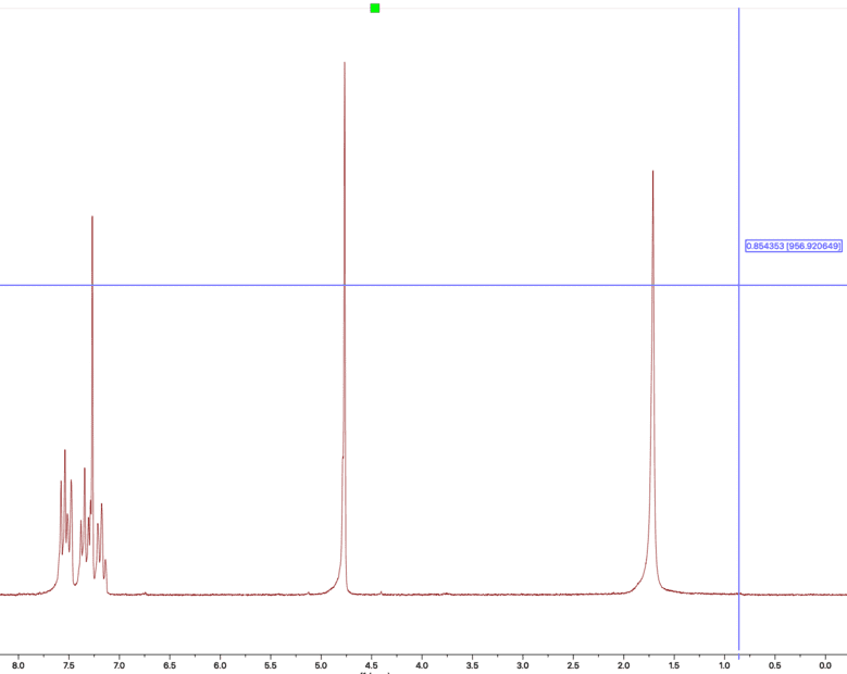

The first picture shows the "raw spectrum" before processing it and the second one is my attempt to process it.
I was not sure about the solvent peak because it is expected to be a singulett at 7,26 ppm but I could not really identify a clear singulett so I dichtet to go with the peak that stood out the most (I'm a total beginner).
I am pretty sure its an aromatic compound because of the signal between 7 and 8 ppm.
the signal at 1,7 could be OH or I guess.
I am not sure about the one at 4,7 ppm it could be a CH2 group attached to an OH maybe.
A thing that would help me first is if I could get the integrals right so I have at least the right number of H-Atoms per peak and I'm also not sure about my peak picking in the aromatic region since a lot of signals are very near to each other in this region so I am not sure if its maybe actually just two signals.
I am very thankful for any kind of help :)
The multiplets in the aromatic region have an integration number of roughly 3.5. The singlet at 4.7ppm has an intgration number of 1, and the singlet at 1.7 has an integration number of roughly 1.5. multiply all those numbers by 2, and you have seven aromatic protons, two chemically equivalent Ph-OH groups and three chemically equivalent ROH groups. There is only one way to put them together that makes much sense, as far as I'm aware. Is that consistent with your melting point?

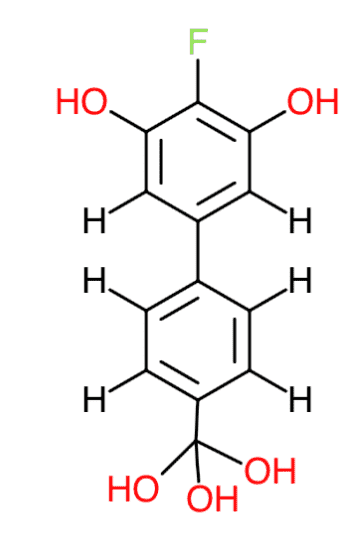

I was thinking something like this:
I am confident about the presence of a ##C(OH)_3## group and less confident about the rest of the molecule, because the integration numbers aren't exact. Even if the molecular formula is correct, the substituents could be arranged differently. Also, the two aromatic rings are not planar like in this drawing, but one is "rotated" 90 degrees relative to the other.

I haven’t looked closely at the spectrum, but a C(OH)3 group will never ever ever in a million years be stable.

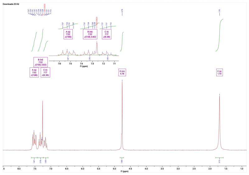

I changed the integral values so currently it looks like this.
I still think that a 1,2 substituted benzene could be possible...like 2-bromobenzyl alcohol.
That is a great and valid point. I guess I've already forgotten organic chemistry 😓.

I think the chloroform solvent peak is dramatically interfering with the integration over the aromatic region. I think that if the peak at 1.7 integrates to 3H, then the aromatic region likely integrates to 4H.
You might be along the right lines for 1,2-disubstitution but integration of the 2 singlets are the wrong way round for this. CH2 of a benzyl alcohol should be ~4.7 but only integrates to one proton.
Likes Sippi7299
yeah, the integration causes the problem here. The singlet at 4,7 says 1,94 for the integration, so I'd say it could be CH2 but the singlet at 1,7 has an integration value of 2,73 so way to high...
the thing is, I know that one heteroatom in the structure is O so the singlets are probably some kind of O group.
I was thinking, maybe the OH integrates so high because it overlaps with the water in the solvent? idk if that even makes senes... what do you think the substituent could be?
Yes, suppose could be water in the sample though CDCl3 is usually pretty dry and surprised you'd be given a problem like this with a confusing peak like that.
Apart from this, does fit with 2-bromobenzyl alcohol as you suggest and the m.p. is spot on!

yeah, the melting point fits perfectly so I just hoped that the peaks would fit too haha.
True, CDCl3 is pretty dry, would be different with DMSO but I know for sure that the solvent is CDCl3.
I'm not sure if I should stick with my answer and try to explain the high integration or try to find another substance... but with the information given, I can't think of much else
one group that would fit the integration would be
but then the melting point does not fit
