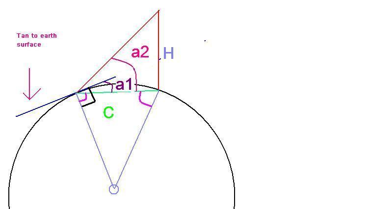

P2. Assume that the satellite of P1 is in orbit at the longitude of Chicago. You are in Chicago (latitude 47.5 degree) and want to pick up the signals the satellite broadcasts. In what direction should you point antenna?
The situation in the problem, as I interpret, is that the satellite is now on the same longitude as Chicago, same latitude as equator, and still hovering over one fixed point on the equator.
If so, the antenna must turn to the south and makes a angle with the ground to point at the satellite.
Now I know the satellite's altitude from P1, I can also find out the distance between Chicago and the Equator,(from the latitude) then I can calculate the angle using Arctan(Altitude/Distance).
But my question is, isn't Earth round? So the distance between Chicago and that Equator was measured by a curved path? Then we wouldn't really have a triangle, right?
Can we still use Arctan() to solve this problem? Or maybe I am just overthinking because the curve can be ignored?

radius of the Earth is touching both equator and Chicago, and using latitudes and longitudes thing you can find the angle between the line connecting equator and Chicago, from the center.
The angle, is the angle the antenna makes with the tangent line to Earth's surface.
It is annoying to explain the geometry, so I just drew it on the file diagram.jpg.
Now I know the satellite's altitude from P1, it is H.
We want the arc radian between chicago and equator,
Using the formula here: http://www.krysstal.com/sphertrig.html
The Cosine rule gives us the central angle.
Note: There can be other ways to get the central angle, because this is a geometry problem, full of hidden paths, but what the heck, I need to finish this before I lose interest.
Now, we have an Isoscele, we know Earth radius, central angle, and the two end angles. So we can find the chord length by law of sine.
Using Arc(H/chord), we got a2.
Now we have to find a1.
Using geometry, a1= 90-[(180-Central Angle)/2)]
The answer = a2-a1
