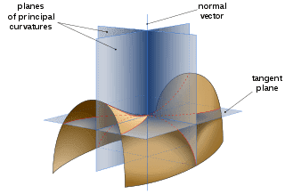

A question of sign. Is the curvature of Flamm's paraboloid positive or negative? If I've gotten the signs correct, it's a negative curvature. This is the opposite of the positive curvature of a sphere, and it implies that that geodesics drawn on Flamm's parabaloid should diverge. I think this makes sense, but a cross-check would be welcome.

Negative curvature is correct.
Intuitive approach: In the 3D embedding it's obviously more like a saddle than a sphere.
If you try to construct tangent circles for the principal extrinsic curvatures in the embedding space, they will be on opposite sides, which implies negative intrinsic curvature.
