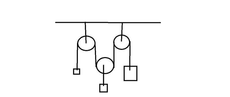

Find acceleration of each mass.
F=ma
conservation of String
Tension is same
T-m1g = m1a1
2T-m2g = m2a2
T-m3g = m3a3
a1=a3=1/2a2 <- I am not sure how to use conservation of string... shouldn't a1 is equal to a3 because there are connected to same sting..
so my question is how to get relationship between/among accelerations

Once you assume the direction, you have to be consistent with it.
I quess you assume m2 is going down.
Thus m2g is greater then 2T.
Add: There 3 possibilities of movement. m1 or m2 or m3 accelerating downward.
Hoi jaw, welcome to PF.
When m2 moves through a distance x in tthe downward direction, how much m1 and m2 move in the upward direction?
If m2 move downward by x
Then should it be m1 move up by x/2 and m3 move up 1/2.
Since string is constant <length
a1+2a2+a3=o
Am I right?
