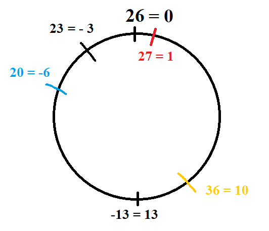

##a \equiv b ## (mod ## n ##) means that ##(a-b)## is an integer multiple of ##n## i.e. ##a-b = kn## for some integer ##k##. You can also phrase this as a and b have same remainer when dividing with n: a = pn + ra and b = qn + rb. But if ra = rb then you have that a-b = (p-q)n = kn i.e. a-b is an integer multiple of n.
Therefore, you can always add or subtract any integer muptiple of ##n## to either ##a## or ##b##, for instance
if ##a \equiv b ## (mod ## n ##) , then:
##a \equiv b + n ## (mod ## n ##)
##a + n\equiv b ## (mod ## n ##)
etc
So in your case, you can add 26 to -3, you can add 52, subtract 26, subtract 52 and so on, and still have the same remained when dividing with 23

As a simple analogy, I like to think in terms of a 12 hour clock.
Clocks read hours as 1,2,3,4,5,6,7,8,9,10,11,12 only.
Hence -3 hours would be 9 o'clock.
