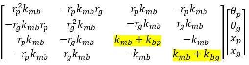

I have been having trouble achieving steady state of this system in my simulations using Simulink and MATLAB, so I was advised to check the eigenvalues of the dynamic matrix as well as make sure that the mass matrix is diagonal while the stiffness matrix is symmetrical - they both are.
The dynamic matrix is defined as the inverse of the mass matrix multiplied by the stiffness matrix, e.g. Dyn = inv(M)*K.
Now, I have input all this into MATLAB with the corresponding values for each of the parameters. However, I can never achieve purely positive eigenvalues for this system, as I'm told is required and may be the issue with my simulation, and where if they're not all positive (including one zero) then the system of equations are incorrect. However, I have reviewed literature on spur gear dynamics and the equations are the same...

I think I can help. Let's start with the eigenvalues, which correspond to (the squares of) your modal frequencies. Since the system you have has exactly one way of moving without causing any forces (when the gears rotate opposite directions according to their gear ratio), you should have exactly one zero-frequency mode. You have three, so yes, something isn't right.
Looking at your stiffness matrix, I noticed there weren't any terms involving the addition of multiple stiffnesses. Whenever motions are coupled by springs, there will be interaction, signaled by stiffness matrix terms containing more than one stiffness.
I believe this all results from your torque and force equations. As written, you are only including the force from the deflection of the stiffness connecting the gears - only kmb appears, not either ks. You need to include the stiffnesses of your bearings; F=kx. Remember that in using F=ma, it's the resultant force applied to the mass, not just one. So each mass in your system should have a combined "bearing force" and "gear tooth" force acting on it.

Hi Randy, thanks so much for your input!
I have updated my stiffness matrix to include the stiffness of the bearings which is now:
And by solving the updated dynamic matrix, has yielded three purely positive eigenvalues with one zero.
So it seems like its responding as it should, now to see the simulation results!
By the way, you can also use Matlab to get the eigenvectors, which are the mode shapes corresponding to each modal frequency (the square root of the eigenvalues). And you can state the eigenvalue problem using the mass and stiffness matrices directly:
[V,D]=eig(K,M)
The columns of V are the eigenvectors, and the diagonal of D is the list of eigenvalues.
