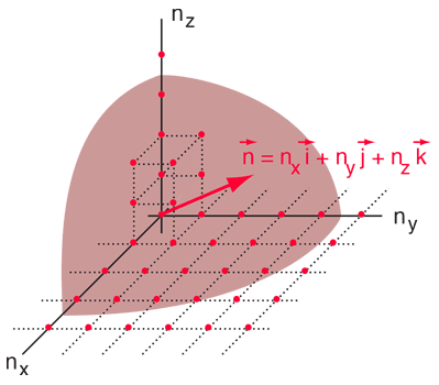

"...let us examine the behavior of the numbers ##\Omega_{1}\left(\varepsilon^{*}\right)## and ##\Sigma_{1}\left(\varepsilon^{*}\right)## which correspond to the case of a single particle confined to the given volume ##V##. The number ##\Sigma_{1}\left(\varepsilon^{*}\right)## on the other hand, exhibits a much smoother asymptotic behavior. **From the geometry of the problem, we note that, asymptotically, ##\Sigma_{1}\left(\varepsilon^{*}\right)## should be equal to the volume of an octant of a three-dimensional sphere of radius** ##\sqrt{\varepsilon}^{*}##, **that is**,
\lim _{\varepsilon^{*} \rightarrow \infty} \frac{\Sigma_{1\left(\varepsilon^{*}\right)}}{(\pi / 6) \varepsilon^{* 3 / 2}}=1.
* Why is the above equation true?

You have to imagine what it looks like in n-space: consider each state as a point ##(n_x, n_y, n_z)## in three-dimensional space, with corresponding energy ##\varepsilon(n_x, n_y, n_z)##.
Asymptotically, these states become so close to one another than one can consider ##n_x##, ##n_y##, and ##n_z## as continuous instead of discrete. In that case, all states with the same energy are characterized by a vector ##\vec{n} = (n_x, n_y, n_z)## of the same length. That vector can point anywhere in the octant where ##n_x##, ##n_y##, and ##n_z## are all positive. The tip of that vector describes (1/8th of) a spherical shell, and the total number of states is the volume of (1/8th of) the corresponding sphere.
(Picture "borrowed" form http://hyperphysics.phy-astr.gsu.edu/hbase/quantum/phodens.html)

Kashmir said:
1) Why do "...Asymptotically these states become so close to one another...? How do we know that they become so close?
I was using the same wording as in your book, but this will depend on exactly how you are taking the thermodynamic limit. For instance, taking ##V \rightarrow \infty##, you have ##L \rightarrow \infty## in the equation for energy and the energy levels become continuous. Also, for ##\vec{n}## big enough, the discreteness of ##n_x##, ##n_y##, and ##n_z## becomes negligible.
Why should the total number of states be equal to the volume of an octant?
Once we assume that the number of states is continuous it follows that they are infinite in number.
It is a matter of counting grid points in ##n## space. Each grid point ##(n_x, n_y, n_z)\ ## corresponds to a microstate.
The number of those grid points satisfying the energy constraint corresponds to a volume in that ##n## space.
