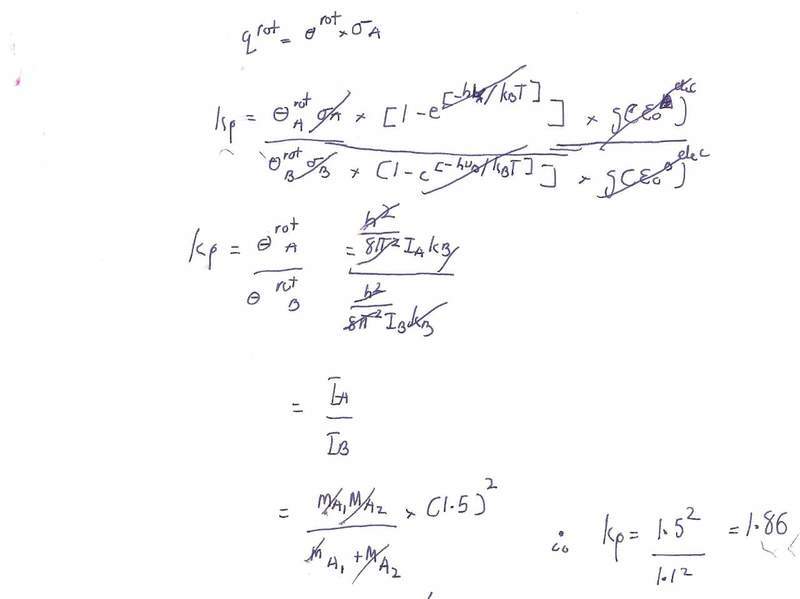

Consider the isomerization of a homonuclear diatomic molecule. The two isomers, A and B, differ only in the bond length which, for A and B, are 1.5 Å and 1.1 Å, respectively. What is the value of the equilibrium ratio of NB/NA?

My attempt: was leaning towards the answer being one, however now I am not so sure because the partition function of rotational motion is given by the characterisitc temperature of rotation and this value is effected by bond length. Please see attached scan for the working out, but I know that this should be multiplied by e^(eob-eoa)/KbT
I have not examined nor analyzed your attachment. You are right in assuming that the rotational partition function is the key to this problem.
With regards to the rotational partition function, I narrowed it down to (1.5)^2/(1.1)^2 multiplied by e^(eob-eoa)/KbT, but I do not know the values of T so how do I complete this?
Or is that actaully part of the ratio since its the ratio multiplied by e^(eob-eoa)/KbT

OK then, Twickel, for the first question, write down the expression that connects delta G° with Kp, and the equation that connects delta G° with delta H° and delta S°. Equate the two different expressions for delta G° with one another, rearrange, and compare with the original question.
For the third question, I am coming around to thinking that the answer must be 1.0.
Why? because no temperature or atomic mass is given, and it is not even stated that we are dealing with a gaseous substance.
If no temperature is stated, then you certainly ought to be able to legitimately take the temperature as 0 K, and at that temperature the answer will certainly be 1.0!
But teachers often do not like that sort of argument.
In my teaching days, I would have rejected a question like this. Why? Because it is more likely to confuse and take up the time of a good student who is on top of the subject than a bad one who does not really understand it, and that makes it an inappropriate exercise and an inappropriate assessment or self-assessment.
Thank you I figured out one and I just maked a low T approx for the second, so it is one.
