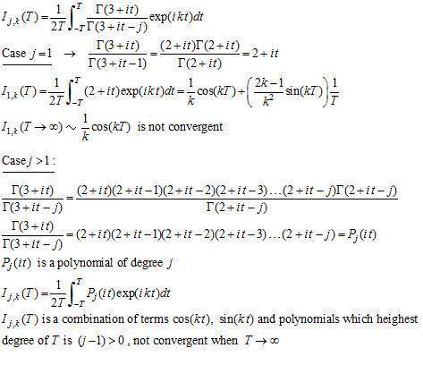

greetings . any ideas on how to evaluate this integral
[tex] \lim_{T\rightarrow \infty}\frac{1}{2T}\int_{-T}^{T}\frac{\Gamma(3+it)}{\Gamma(3+it-j)}e^{ikt}dt[/tex]
[itex] j, k [/itex] are positive constants .

Hi !
this integral cannot be evaluated for T-->infinity because it is not convergent.
The gamma function ratio is a polynomial in t (degree = j, if j is an integer).

Not sure, but would a Fourier transform help here?
I don't think so. Since the integral is not convergent for T tending to infinity, the Fourier transform is of no help to find a limit which doesn't exist anyways.
This is a so-called Pochhammer polynomial.
