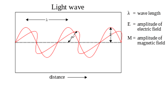

https://en.wikipedia.org/wiki/Photon
There are only three things marked on that diagram, wavelength, amplitude of electric field and amplitude of magnetic filed. Waves naturally have amplitudes just like they have a wavelength. How else would you know what is the wavelength if you don't know how far apart are the peaks of the amplitude?
  • #45
Again, you are confusing the classical wave with the photon. That diagram describes a Wave. Is there any mention of photons on it? You seem to be repeating the same thing to yourself, 'explaining it' to PF in your terms, drawing diagrams from inside your head and not accepting any new input about this. Photons and waves are DIFFERENT aspects of the same thing. If it were as straightforward as you seem to think then why would thousands (even more than that) of really clever Scientists have had a problem with it? Your model doesn't actually take you into QM, it just tinkers with the ancient 'corpuscular' theory and tries to make those little corpuscles a bit wiggly.
Everyone goes through this stage of thinking (I am not being patronising) and, once you start asking the sort of questions that you are asking, the ground is continually shifting. You sit there and 'the answer' comes into your head. Later, you realize that it isn't the answer but you modify and re-think. I compare QM with trying to grab the soap in the bath - you touch it with your fingers so you know it's there but it slips away when you put your hand round it. It is a lot easier to say what a photon isn't rather than what it is, which is why you are getting some negative reactions here. You must open your mind beyond where it is at the moment if you want a chance of progressing.
I'm afraid that I can quite confidently say that you have got it wrong, so far. It won't come to you - you have to go to it. :smile:
BTW, from the whole of that wiki article, why did you pick the one diagram that shows the classical description of a wave when photons are dealt with everywhere else?
Is single photon not oscillation of electric and magnetic field? Does a singe photon not have wavelength? Can a single photon not be polarized? The title of the article is "photon", it also says: -"Einstein showed that, if Planck's law of black-body radiation is accepted, the energy quanta must also carry momentum p=h/λ, making them full-fledged particles." Full-fledged particles, they say.
How are photons and waves different aspect of the same thing? What is that "thing"? Let me tell you, there is electric and magnetic fields, they are kind of particles since they have momentum, and they oscillate as they propagate, so there it is the wave too. You get exactly what you said, both particles and waves, two aspects of the same thing.
That's not my model, it's what Maxwell came up with. Combined electric and magnetic field and it turned out they would oscillate while propagating at the speed of light. Then Einstein figured out they have momentum, making them "full-fledged particles", to quote Wikipedia.

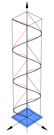

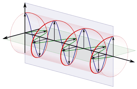

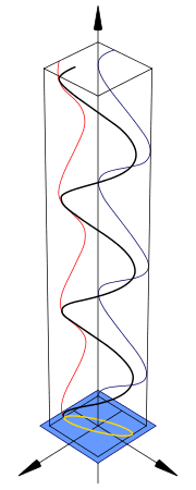

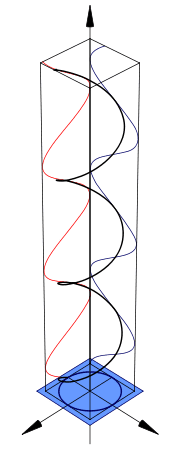

How about this:
https://en.wikipedia.org/wiki/Polarization_(waves)
...and this:
https://en.wikipedia.org/wiki/Circular_polarization
440px-Circular.Polarization.Circularly.Polarized.Light_With.Components_Left.Handed.svg.png
Does that have nothing to do with reality? Just an abstraction, a cartoon?
