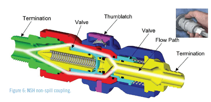

Does water drain out of the chiller when tubing is disconnected, or not? If it doesn't, then the chiller connectors have internal spring-type check valves similar to this.
246384
I don't have experience with malfunctioning connectors this small, but their larger brethren sometimes become partially jammed and exacerbate flow variations, particularly at low flow rates. Can't say whether it is relevant in this case, but worth keeping in the back of your mind as an unlikely possibility.
