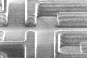

In summary, lithography is a fundamental optical-chemistry technology that is used to create integrated circuits and circuit boards. The ridges that appear on the sidewalls of the photoresist material are well known and are caused by the exposure of the photoresist by the standing waves of light used to expose the photosensitive polymer. Classical optics, based on EM field theory, is used to describe this effect.

It has been determined (general consensus) that this pattern is caused by the exposure of the photoresist by the standing waves (constructive and destructive addition of the E field) of light used to expose the photosensitive polymer ( photoresist ). Classical optics, based on EM field theory, is used to describe this effect. In fact, the problem is easily solved by coating the substrate with an absorbing material, so there is no reflection. If you read the referenced paper, that layer is called BARC ( Bottom Anti-Reflection Coating).

If this is a common effect can you point me to similar images or suggest a good Google search for them?
Yes you can Google "standing wave patterns in photoresist" and hundreds of sites will appear. What I suggest you do is Goggle the term and then switch to image mode, there you will find many examples. (SEM micrographs). Here is one such page that illustrates the issue: http://spie.org/newsroom/4198-in-si...terization-of-photoresists-during-development Now if you read my first post, I said that EVERY integrated circuit and circuit board in Every computer in the world is fabricated using photolithography technology. And how do I know this? Well I was the Director of Research of Lithographic Processes and Systems at AT&T Bell Laboratories for 6 years. That was 1984 through1989. I was also the co developer of exicmer laser projection lithography at the Labs and we were the first research and development team to use krypton fluoride lasers (248nm) as light sources. But my formal training is a theoretical nuclear physicist. I hope that these discussions get deeper and more individuals get involved, since there is some wonderful physics problems that are seen everyday in the manufacturing world and never get the attention of the research community. After my PhD, I worked in the Allentown Western Electric Factory researching materials, transistor and device physics and processing techniques used to fabricate silicon integrated circuits. After fifteen years, I was promoted and reassigned to the Murray Hill Central Research Laboratory, where I was the manager of all advanced lithographic development. You can find me by Google

Your search suggestion yielded this,
https://people.rit.edu/deeemc/courses/0305-676/swingcurves/standing_waves.pdf
which seems to account for the effect using only classical physics. But we are told everything is quantum, classical physics is only the proper limit of quantum physics?
Are the ridges a problem?
The ridges can be eliminated by using a underlying coat of material called BARC (Bottom - Anti -reflective Coating) which is applied under the photoresist material.
