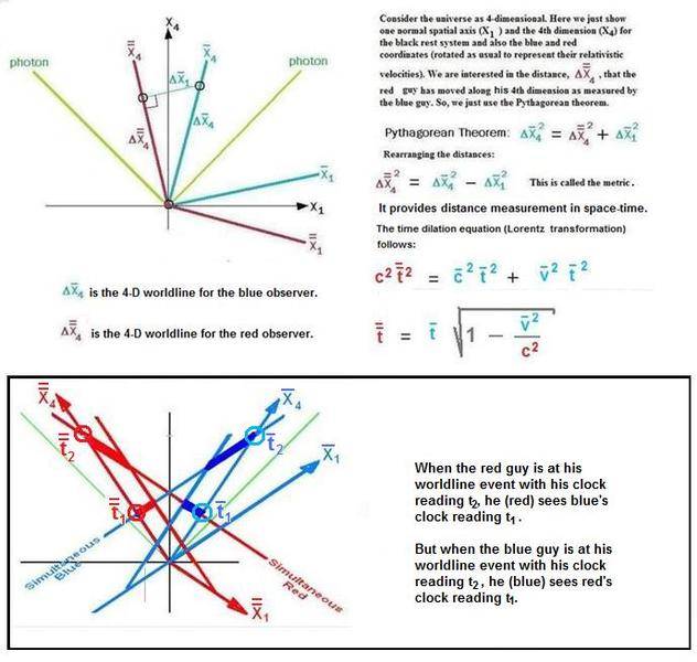

Following up on Muphrid's excellent and efficient response I'll sketch the Minkowski space-time diagram for the clocks. Using the Loedel form of the diagram we have red and blue observers moving off in opposite directions with the same speed with respect to a black rest frame. The distance and time measurements then have the same calibration in the sketches. The upper sketch is used to derive the time dilation equation (Lorentz transformation). In this derivation we embrace the concept that all observers move along their respective worldlines (along their 4th dimension) at the speed of light): dx4 = c(dt).
The lower sketch shows the different cross-section views of space-time for red and blue observers--this makes clear the explanation underlying the length contraction and time dilation phenomena of special relativity.

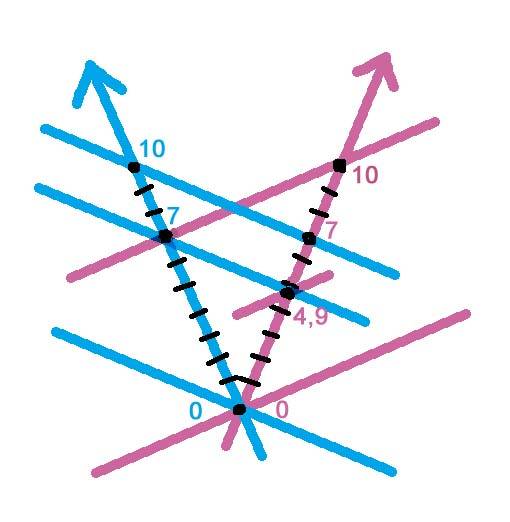

This sketch might help to visualize the loedel diagram Bobc2 talked about:
For pink observer his 10 pink heartbeats for 7 blue heartbeats.
For blue observer his 7 blue heartbeats for 4,9 pink heartbeats.
For blue observer his 10 blue heartbeats for 7 pink heartbeats.
The world of simultaneous events for both observers is different. That's relativity of simultanaeity. Event blue heart at 7th beat and event pink heart at 4,9th beat are simultaneous for blue observer (they happen in one blue world if simultaneous events), but those two events do not happen simultaneously for pink observer (i.e. not both in one pink world of simultaneous events; they happen one before/after the other)
