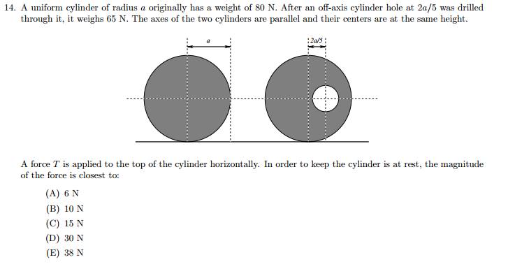

    I can't wrap my head around this problem?
    I think that when you drill a whole like that, the cylinder will roll back to attain its equilibrium so need to hold it with a certain torque to keep it in place, but i do not know how to find the torque
    What i have in mind is:
    since T=dL/dt, but L=Iw(w is angular velocity) so T=Ia(a is angular acceleration). So i'm trying to find a balanced torque but i do not know how to find the new moment of inertia? Do we use the parallel axis theorem? or it doesn't work because there's hole in it?? HELP!!

    This is the same thing as if you took the original cylinder and applied an upward force of 15N at the location where you drilled the hole (i.e., at the location of the center of the hole).

  5. Apr 4, 2014 #4
    Removing material is the same as adding negative material (or gluing on negative weight material).
    Chet
  6. Apr 4, 2014 #5
    but.. the right answer isn't 15N it's 6N?
  7. Apr 4, 2014 #6
    You need to put the 15 N force in where I said, and then do a balance of moments to figure out what additional force you need to apply tangentially at a to get no net moment. For example, the moment of the 15 N force is 15(2a)/5.
    Chet
  8. Apr 4, 2014 #7
    OH!!! I GET IT! THANKS DUDE! still kinda not intuitive about the idea of that 15N upward force, what if the shape it different or cutting 2 shapes of different of different size?? is there a mathematical way to determine that 15N?
