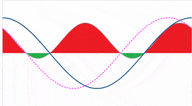

Except for the special case of the load being purely resistive, the power in AC does alternate with each positive pulse followed by a smaller negative pulse to deliver an average power that is positive.Windadct said:Personally I never liked the "C" - because power requires voltage AND current. In AC BOTH the voltage and current change polarity - so (typically) the power is always flowing in one direction.
NascentOxygen said:Except for the special case of the load being purely resistive, the power in AC does alternate with each positive pulse followed by a smaller negative pulse to deliver an average power that is positive.
Maybe you didn't understand what I wrote?anorlunda said:Sorry, but no. The positive and negative half cycles are the same size and there is no pulsing. When V and I are in-phase, V*I is positive when both V and I are positive, and V*I is positive when V and I are both negative. Look at the drawings in the Insight article.
https://www.physicsforums.com/insights/ac-power-analysis-part-1-basics/
