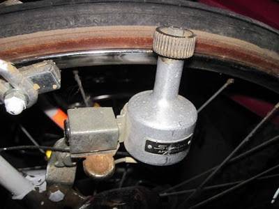

there exist bicycle lighting generators that'll do that, about 6 volts maybe half amp..

That dynamo has seen a few miles in the dark and the rain, Jim!
Actually, it's normally the magnet that's rotated and the stator is the coil. No slip rings required, that way. A good rectifier circuit is much more effective than a commutator and rotating coil for getting DC power out.
