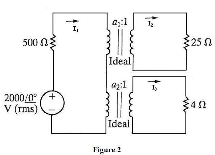

The sinusoidal voltage source in the circuit shown in Fig. 2 is developing an RMS voltage of 2000V. The 4ohm load in the circuit is absorbing 4 times as much average power as the 25ohm load. The two loads are matched to the sinusoidal source that has an internal impedance of 500<0 ohms. (please see attached circuit)
Specify the numerical values of a1 and a2
(V1/V2)/(N1/N2)=(I1/I2)=a
I have no idea on how to do this :( can someone please help me? We haven't done much on questions like this. thanks
Circuit diagram
Can you specify the currents in the secondaries in terms of the a's and I1? How about the power being dissipated in the secondary resistors?

Yes, so what are the powers in terms of I1? Also, you're given a relationship between those powers, so determine the relationship between the a's.
You now need to find out how to use the givens in the problem statement.
The two loads are matched to the sinusoidal source that has an internal impedance of 500 ohm
From this statement you can compute a number for I_1 and find the voltage across the internal impedance and the voltage across the left coils of the transformers. You need to consider what it means for the loads to be matched to the source. From the answer for I_1, you can find the power being put into the left side of the transformers.
Knowing the power input to the transformer and the above statement, you should be able to figure how much power is being spent in each loop on the right. Knowing the powers can you now find I_2 and I_3?
Knowing all the currents allows you finally to find a1 and a2.

Rather than go directly for the current in the primary loop, it may be easier to consider the given claim that the loads are matched to the source's impedance. Transformers have the property that impedances in the secondary circuits are 'reflected' back into the primary circuit. So a resistance R in a secondary loop of an N:1 transformer will cause the primary loop to behave as though there was a series resistance N2R in it.
What should be the total resistance reflected into the primary circuit if the loads are matched to the source impedance (given as 500 Ohms)?
Okay, I've taken the reflective advice and matched it with what i already have figured i think I've got it.
Anyway, i get
a1=2 a2=10
I2= 8 A I3=40 A
I1= 4 A

Just realized, does the internal impedance of the 2000<0 V have an effect on the left hand circuit? i can't decide if the current I1 is equal to 2<0 A or 4<0 A. I mention it before when i said
*Is I1 = (V1)/(R1) meaning I1= (2000<0)/(500<0) = 4<0 A? Or does the internal resistance of the source come into play meaning that for the left hand loop, I1 = (2000<0)/(500<0)+(500<0) = 2<0 A *500 ohm resistor + 500 ohms of internal resistance*
The source's internal impedance is in series with the source voltage, and you can't avoid or ignore it. The load impedances (resistances in this case) will be reflected into the primary circuit, too, and those reflected impedances will have to be added. So the primary's current will be
[tex] I_1 = \frac{2000V}{Internal + Reflected} = \frac{2000V}{500 \Omega + 500 \Omega} [/tex]
