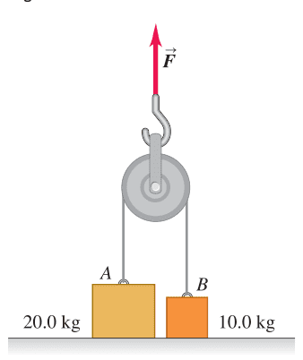

The masses of blocks ##A## and ##B## are 20kg and 10 kg, respectively. The blocks are initially at rest on the floor and are connected by a massless and frictionless pulley. An upward force ##\vec{F}## is applied to the pulley. Find the accelerations ## \vec{a_A}## of block ##A##, and ## \vec{a_B}## of block ##B## when F is (a) 124 N ;(b) 294 N ; (c) 424 N.
Newton's second law of motion. Relative acceleration formula
I think it would be convenient to work in the pulley's frame. Since that is a non-inertial frame, I will need to introduce fictitious force in the analysis, so that I can use Newton's equations of motion as usual. Now let ##x_1## and ##x_2## be the coordinate of the blocks ##A## and ##B## as measured downward from the pulley. So, I am taking downward direction as positive. Since the system is accelerating upwards, I will need to introduce a fictitious force ##F## acting downward on each block. Let ##L## be the length of the string, then we have ##x_1+x_2=L##, which means ##\ddot{x_1} + \ddot{x_2} = 0##. Now equations of motion in the pulley's frame would be $$m_1g +F - T = m_1\ddot{x_1}$$ and $$m_2g +F - T = m_2\ddot{x_2}$$ where ##T## is the tension in the string and ##m_1## and ##m_2## are the masses of blocks ##A## and ##B## respectively. Subtracting two equations we get $$(m_1-m_2)g = m_1 \ddot{x_1} -m_2 \ddot{x_2} = m_1 \ddot{x_1} + m_2\ddot{x_1}$$ Solving, we get $$\ddot{x_1} = \frac{(m_1-m_2)g}{(m_1+m_2)}$$ Does it look alright ? There is no ##F## involved here. So I think I made mistakes somewhere.
Fictitious force acting on the two masses will be different .
If the force ##F## is applied externally, then usually we take fictitious force as ##F## acting in the opposite directions. So would it not be same for both the blocks ? Why is it different ?

No .
Fictitious force is given by mass of the object times acceleration of the frame of reference , acting in the direction opposite to the accelerating frame .
@IssacNewton this is a much simpler problem then you are thinking . Perhaps the moving pulley has thrown you off :wink: .
I just wanted to solve it using the fictitious forces. So if the net force on the system of pulley and the blocks is ##F##, using we can take the total mass of the system, which is ##m_1+m_2##, so acceleration would be ##a = F/(m_1+m_2)##. So in that case, the fictitious force on ##m_1## would be ##Fm_1/(m_1+m_2)## and fictitious force on ##m_2## would be ##Fm_2/(m_1+m_2)##. Using this, we can modify the equations as follows
$$m_1g + \frac{Fm_1}{(m_1+m_2)} -T = m_1 \ddot{x_1}$$ and $$m_2g + \frac{Fm_2}{(m_1+m_2)} -T = m_2 \ddot{x_2}$$ Would this be ok ?

Now if ##a_1## is the acceleration of block ##A## with respect to the ground, we also have ##F=2T## for the pulley. So equation of motion for block ##A## would be (upward directions are taken positive), ##T- m_1 g = m_1 a_1##. Since ##F=2T##, we have ##(F/2) - m_1 g = m_1 a_1##, so ##a_1 = \frac{F}{(2m_1)} - g##. And similarly, if ##a_2## is the acceleration of block ##B## with respect to the ground, we will get ##a_2 = \frac{F}{(2m_2)} - g##. Is it correct ?
Yes .
Now , from the constraint relation you can find the acceleration of the pulley :smile: .

The important thing you might be overlooking/missing is that initially both the blocks rest on the ground .
To answer the original question , just analyse the forces on the two masses :smile:
So when they are in contact with the ground, there will be weight downwards and normal reaction and the tension upwards. So, when the masses are lifted, their normal reaction would be zero. For the left mass, the normal reaction would be ##N_1= m_1 g - T = m_1 g - \frac{F}{2}## and for the right mass, the normal reaction would be ##N_2= m_2 g - T = m_2 g - \frac{F}{2}## when both of them are on ground. Now for ##F= 124\,N##, we get ##N_1 = 134 N## and ##N_2 = 36\,N##. Since in both cases, the normal reaction is positive, both the masses will remain on the ground. Now when ##F = 294\,N##, we get ##N_1 = 49\,N##, and ##N_2 = -49\, N##. Since ##N_2 < 0##, this means that the right mass will be lifted from the ground, but as ##N_1 > 0##, the left mass will remain on the ground. When ##F = 424\,N##, we get ##N_1 = -16\,,N## and ##N_2 = -114\,N##. Since both ##N_1 <0## and ##N_2 < 0##, both the masses will be lifted up from the floor and pulley will also move. So pulley will move when ##F = 294\,N## or ##F = 424\,N##.
Is this analysis correct ?

Looks alright .
So when ##F = 294\,N##, the left mass will remain on the ground while the right one will start moving. Let ##a_2## be the acceleration of the right mass with respect to the ground. Then I have already found in post #12 that ##a_2 = \frac{F}{(2m_2)} - g##. Plugging the values, we get ##a_2 = 4.9\, m/s^2##
Now when ##F = 424\,N##, both the masses will be lifted from the floor, so using the formulae in post #12, we get ##a_1 = \frac{F}{(2m_1)} - g = 0.8\, m/s^2## and ##a_2 = \frac{F}{(2m_2)} - g = 11.4 \,m/s^2##.
I hope this is right. :smile:
Yes
