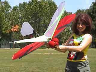

Objective is to prove by a model that flight with flapping wings is practicable.
Leonardo da Vinci had no current materials composits (Carbon, fiberglass etc.)
The already model shows that it is possible .The necessary power is lower than that of a classic plane of the same weight by disregarding the Cx.
For the human transport it is still UTOPIA.
Robert Korobelnik
http://ovirc.free.fr
Can they hover? Can they be made fast? Cab they be made big?
Can they hover? yes
Can they be made fast? Yes and so bought ready to fly
Cab they be made big? Certainly in a few years
Aerodynamics for small airfoils is different than for large ones. Structural loadings scale as well. Because of these two issues, flapping wings will not scale to human-sized craft.
