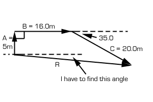

I have another question, but this one is relating to a different problem.
My diagram is attached below. It's another vector addition problem.
I have to find the resultant plus theta.
So this is what I have currently to find the components.
Ax = 0 (but I think I have to find this?) Ay = 5m
Bx = 16.0m By = 0
Cx = 0 Cy = 16.4m
I know from here I would add all x's and y's and then use the forumula
R = (the square root of) x^2 + y^2
Then find theta accordingly. However, my problem lies in finding theta. I believe that I should have an amount for Ax. Is that correct?
Both right.
Bx = 16.0m By = 0
Right.
Cx = 0 Cy = 16.4m
Both are wrong!
Hmm, ok let me go back to the drawing board on this one.
Alright how about this?
Cx = - 11.5m Cy = - 14m
Ok never mind on finding the resultant. I've got that. But now I'm facing a different problem. I am using tan to find theta by using:
theta = tan^-1 (27.5/14) but when I enter the answer I get from this it says it's wrong. (By it, I'm referring to webassign). Anyway my problem it would seem is that either I'm not using the right function, i.e tan, or I'm not using the correct distance for y.
You can look at the above diagram in post # 12 for referrence.
Here's what I get:
Cx = 20 cos(35) = 16.4
Cy = -20 sin(35) = -11.5
Your distances (components of the resultant vector) for both x and y are wrong.
There's nothing wrong with your method for finding the angle, but since you have calculated the components wrong you will of course get a wrong answer. Add up the components correctly, then redo the calculation to find the angle.
That's interesting considering when I submited my resultant answer for my x and y components, it was correct. The only difference was that my resultant answer was 33.4 and when I tried it using the Cx and Cy components you gave the resultant was 33.04.
In any case, I found theta to be 11.3.
What did you get for your x and y components of the resultant?
Sounds right.
My first original answer was that x-component = 27.5 and my y-component = 19.
That gave my resultant a length of 33.4m. Which when I entered it into webassign, was correct. But as I said earlier my angles were off, and I wasn't putting two and two together, realizing I was getting enormously huge angles for the small angle that was pictured on the diagram.
But as I said earlier. When figuring out the resultant with the Cx and Cy components you gave me. My resultant was 33.04 and theta was 11.3. Which made a lot more sense then originally.
