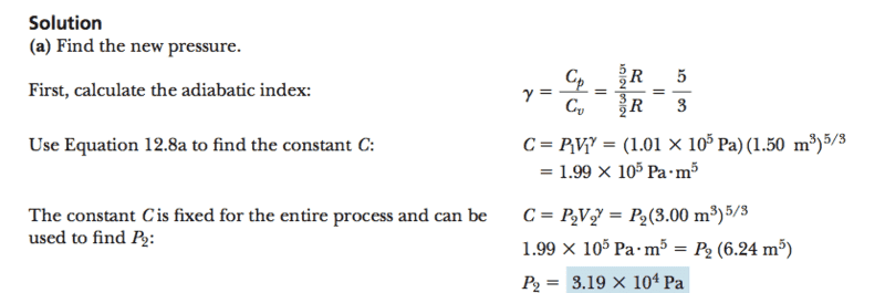

see attachment
I'm having trouble where they multiply (101,000 by 1.5 m3)5/3
I get 151,500 Pa*m5
not 199,000 Pa*m5

bobsmith76 said:
see attachment
I get 151,500 Pa*m5
not 199,000 Pa*m5
The adiabatic condition is:
[itex]PV^\gamma = K[/itex] which means [itex]P^1 \times V^\gamma = K[/itex]
Since [itex]\gamma = 5/3[/itex], and V = 1.5, [itex]V^\gamma = 1.5^{5/3} = 1.97[/itex]
