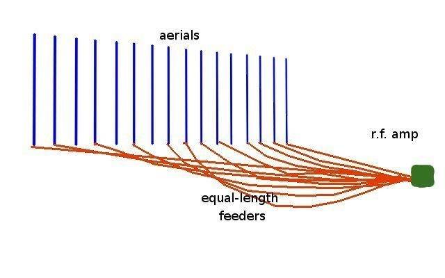

Absolutely a well-developed field. Search on phased array radar, and you'll see lots of fun geometries and techniques. Heck, we even had a phased array HAM antenna setup a year ago at Field Day, with 4 antennas with variable phase delay feeds to focus the pattern in different directions. I think it was a 20m array, but I could be wrong about that. Didn't matter much anyway, because the skip sucked last year. Much better skip this year though!
Thank you very much.
Then is it possible to drive a rectangular plane as a very dense array, whose elements are touching?
I wonder whether copper mesh could be cut to the arc of a circle to feed the plane. By increasing the diameter of the circle the bellying in the path could be made arbitrarily small.
It sounds like easy low-noise comms so far. Surely there's a catch?
Maybe you could draw what you have in mind.
You can split a flat sheet of metal into two halves and feed the halves with RF, but it will act pretty much like a dipole.
Flat planes of metal generally form omnidirectional or donut shaped radiation patterns. It is a bit like getting magnification from a plane mirror. You really can't do it.
An example is the slot antenna.
Believe it or not, a slot cut into the surface of a flat piece of metal can radiate. This is done at microwave frequencies ie 2 GHz up.

I must be very stubborn, or something, on this because I keep thinking of tens, or hundreds, or thousands of dipoles closer and closer together, and wondering about making a plane resonate in a similar mode.
from an earlier post:
"A dipole in free space will have an impedance of about 72 ohms if driven at the centre.

I am attracted to the idea of an r.f."wave machine", which if I read the above-quoted idea correctly ought be drivable from a standard r.f. amp at ordinary voltages and impedances.
The drawing shows a very sparse version of what I have in mind on the matter of feeders.
I wonder whether the many coaxial feeders driving many dipoles could be replaced by a single distorted planar feeder driving a planar dipole, to achieve a high degree of spatial selectivity.
I'm not sure what actual layout you have in mind but the "catch" may be in the fact that you have to consider the total path length of signals from feed to each element. What did you want this circular plate to achieve? Perhaps a simple diagram. . . . .

This is where a simulator can help.
I put 4 dipoles, each 39 inches long and mounted one above the other, into Eznec Demo V5.
At 1/4 wave spacing, 20 inches, there was about 4 dB gain over a dipole even though there was already massive interaction between the dipoles. The two in the middle were most affected and showed poor SWR at the resonant frequency of the other outer dipoles.
I have attached a copy of the EZ file for this. It needs to be unzipped and placed in the ANT directory of EZW in Program files.
Feeding each dipole at 180 degrees relative to the one next to it produces a gain of about 7dB over a dipole but directed in the line of the dipoles (ie up or down in this case).
You have probably seen TV antennas where the feedline went to each element but crossed over to the opposite side along the support boom each time. This is a similar antenna.
The SWR for this arrangement is pretty poor for all dipoles and would need to be adjusted by rearanging the lengths or spacings of the dipoles.
Placing the dipoles 2 inches apart and feeding them in phase resulted in radiation that was mostly along the line of the dipoles but with severe interaction between the dipoles. Gain was less than for a dipole in any direction.
If you can, try to locate a copy of the ARRL Antenna Book. A lot of these antennas have been around since the 1930s.
