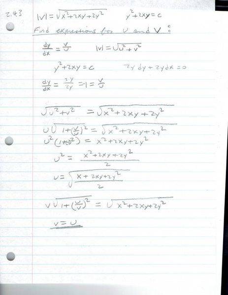

The absolute value of the velocity and the equation of the streamlines in a velocity field are given, respectively,
|V|=sqrt(x^2+2xy+2y^2) and y^2+2xy = C
Find expressions for u and v.
dy/dx = v/u
|v| = sqrt(u^2+v^2)
included in attachment
Most of your steps look good. Remember that
##u^2 = f(x,y) ##
implies
##u = \pm \sqrt{f(x,y)}.##
This is important because you need to be consistent and keep ##\frac vu = -1##.
Thanks, my only major concern is that when I take the partial derivative, how do I know which term to take derivatives in respect to y or x. Do I have to make assumptions?
