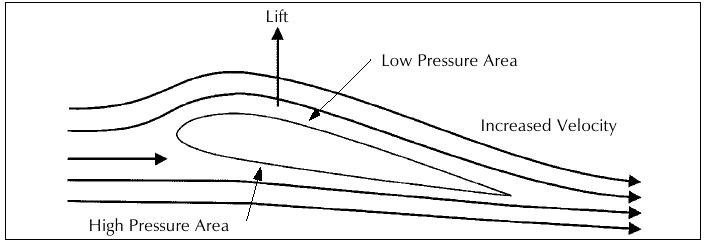

Rishi Gangadhar
Consider this aerofoil. Let the leftmost point be S and rightmost point be E. Let the topmost point be T and a point on the bottom of the foil be B.
Let the wind blow as shown in the figure above.
Bernoulli's principle says that the air blowing along S-T-E must travel a path longer than than that traveled by air blowing along S-B-E, and for the time taken to reach E must be the same, the wind blowing through the top of the foil must have a higher velocity and hence the pressure on the top of the foil is lesser than that on the bottom part of the foil and hence the plane takes off.
But, why should the air blowing along S-T-E and S-T-B take the same time to reach E?

No. Bernoulli's principe does not say this. Nothing in physics says this. It flat out is not correct. In fact, the air moving over the top move much faster than below and leaves the trailing edge quite a bit before a particle reaching the leading edge at the same time but traveling underneath reaches the trailing edge. This is commonly called the equal transit time fallacy.

Bernoulli's principle does describe why a packet of air might speed up or slow down (that's basically its entire point): it's the pressure that provides the force to accelerate the packet of air.

Pressure is lower on the top of the airfoil not higher. The streamlines get closer together as a result of mass conservation. And the streamlines being closer together is not an indication of compressibility.

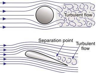

This is turbulent because there is a change in pressure with space (the pressure does change as the air moves towards the foil).
Turbulence does occur when you have variation of pressure with space and time.
This is What actually happens in the case of an aerofoil (look at the second diagram).
So what you have shown here are turbulent separation bubbles. Yes, those bubbles contain turbulent flow, but they are not the definition of turbulent flow. Turbulence itself is a much broader concept. Turbulence is characterized by rapid changes in both time and space of the various flow variables like temperature, pressure, and velocity. If you were to measure one point in a turbulent flow, it would be highly erratic and look essentially like fairly large random fluctuations around the mean quantity of whatever you are measuring. In the scope of the whole turbulent flow, the most notable characteristic is that it contains eddies (or vortices) of many different sized, where the larger eddies contain a lot of energy and gradually dump energy into smaller and smaller eddies until it is small enough that viscosity can dissipate the energy. In other words, in the pictures you posted, the important part that indicates turbulence are the crazy, "chaotic streamlines" drawn in the turbulent regions, not the fact that there is an abrupt change in pressure.
In every single fluid flow that is even remotely interesting, pressure changes with space and time. However, many of those flows are laminar. What is important is how variables like pressure change with space and time. You can certainly have laminar flow over an airfoil or around a sphere, and those certainly involve pressure changes with space and time. In a laminar flow, though, the fluctuations about the mean value are very small and predictable, whereas in a turbulent flow, they are much larger and not practically predictable.

In true streamline flow the streamlines getting closer together means that the flow is speeding up . Draw the stream lines passing through a 2D venturi and all should become clear .
