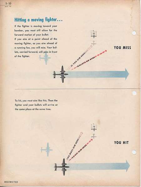

Practical example of the aircraft with things being dropped from it includes bombers in WW2. You are defensive machine gunner responsible for defending American bomber against German attacking fighter aircraft.
The phenomenon really made it difficult sometimes for defensive gunners to shoot accurately at enemy aircraft. Look at the picture and decide if it looks counter-intuitive or not! oo)
Defensive turret gunner had to calculate "lead shooting" because normally a moving target requires lead shooting (I'm sure this applies even with stationary shooter, and moving target example of a duck hunter with a shotgun for example)
But the bomber always had to keep going forward. That was the tactic of the day. Tactic called for staying in formation with the bombers and not making evasive moves. (they would cost lot of fuel, and bombers would not reach distant bombing targets and still make it back).
It becomes less counter-intuitive if you consider the velocity of the fighter relative to the bomber, which is not south, but south-west.
But the picture is also misleading, probably because it is not correctly scaled. What it shows would apply if the fighter was still further north (which probably was the normal situation when the gunner started firing).
In the situation shown in the picture however, the gunner should aim at the fighter if the planes have the same speeds, and in front of the fighter if the fighter is faster than the bomber (the likely case). So the picture is physically wrong, but it gives the right practical advice for the start of the fire. Real life was more complex anyway because the fighters were changing direction.

Usually the fighter was almost always quite a bit faster than bomber. Reasoning was that the German pilots figured that speed would give them a measure of safety (at least in their mind!)
Fighters would be making diving strafing passes at the bombers. At speeds up to 650- 700 km/h true airspeed.
Let's say that Fighter is moving at 650 km/h and bomber is moving at 450 km/h
