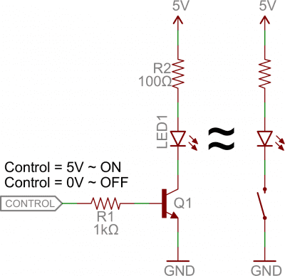

I am carrying out a physics experiment to measure g by free fall using an Arduino. This experiment requires accurate time measurements of upto a millisecond. I am using a relay to turn on/off an electromagnet and there is a maximum lag of 10ms due to the relay. I am a complete beginner. Please suggest alternative mechanisms to switch the electromagnet and save those precious milliseconds. P.S. - the magnet is driven by 12V 2.5A DC.
UPDATE
I tried something like this using an NPN 2N2222A transistor. This transistor couldn't hold the required current for the electromagnet and a lower power supply was not strong enough.
You can get a better transistor. A few Volt, a few Ampere - should cost less than shipping costs if buying one is an option.

As you warned, the magnet is playing a huge role. I am getting g as about 860 cm/s. I believe this lower value is because initially there is an upward acceleration due to the magnet on the falling object. I am using a DIY electromagnet with an iron bolt as its core. How can I make the magnetic force die away instantly?
To make the relay lag error less significant I increased the fall height to about 200 cm, thus increasing the fall time. I plan to buy transistors that can take the 12V 1.5A DC load.

I now used a heavier mass and it gave me values closer to the accepted value of g. I think this is because the gravitational force(proportional to mass) now dominates over the magnetic force. I am surprisingly getting about 950 to 960 cm/s. I will upload the Arduino code if the need be.

Something like that would be much better - you are never going to get the response time of the solenoid down to nothing .
A common set up is for the test object to be held in place by a latch - something like a door bolt but a bit more sophisticated . The solenoid then just pulls the bolt out of engagement - the actual point of release is detected by an independent detection system .
Something to always take into account with latch and release systems is to make sure that they don't put any impetus into the test object or launch it slightly crooked . For this reason latch and release systems are often arranged to be axially symmetric . Most common arrangement is to have three latches arranged radially . That's just for interest - you'll do perfectly ok with a single latch if you are careful with it's design .
That's a good result . Entirely logical since the heavier object will overcome any residual solenoid force earlier on in the transient turn off period .

A quick release can be made by reducing the voltage on the electromagnet so it is only just holding the falling object.
For the falling object, do not use just a piece of iron.
This will magnetise the iron and it will take a short while to let go.
A better falling object is a ball from an old rolling ball computer mouse. These are rubber coated iron and let go of the electromagnet instantly.

Your electromagnet is probably too powerful.
You could use a relay coil with the contacts removed.
Place a computer mouse ball at the end of the relay coil and apply just enough voltage to attract the ball.
You can drive this relay coil with a small power transistor. Just remove the power to release the ball.
This is easy with an Arduino.
