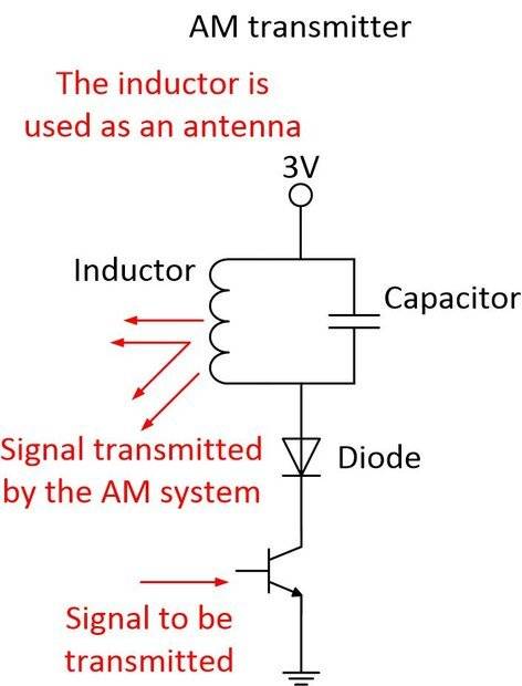

Hi, guys! Could anyone provide an explanation about how the following AM transmitter works? It is similar to the AM transmitter for project 122 of the Snap Circuit kit by Elenco. Does it work as a switching modulator?
What does signal to be transmitted mean? Is it the modulating audio or the amplitude modulated carrier?

You can see the system working in the following video. The audio is in Spanish but it shows the system working.
Audio signal

Summary:: AM transmitter

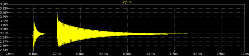

Only the positive peaks of the audio turn the transistor on and sink current.
That current flows through the tuned circuit and causes bursts of oscillation.
The tuned circuit is being “plucked” like a string.
Bigger positive peaks sink more current than small peaks.
The amplitude of the oscillation is determined by amplitude (and frequency) of the audio.
In a sense it is a class C transmitter.

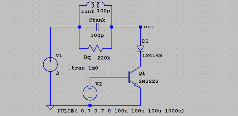

Interesting. I may have to simulate it to see what is going on. It's hard to believe that snapping a 2nd order LC resonator on and off won't result in out-of-band harmonics, but you might be right. The bandpass filters that I'm more familiar with in the WiFi band are much steeper than 2nd order.
I do not believe it is being "snapped" on and off.
Another interesting point, worthy of simulation, is the purpose of the diode.
Likes Klystron, DaveE and Keith_McClary
I'll go out on a limb here: :wink:
Probably to give the edges to shock-excite the tuned circuit.
When the diode is Off it would also serve to isolate the Collector capacitance of the driver from the LC cicuit.

It looks as if the transistor forms an oscillator at the frequency determined by L and C. Not sure how exactly. It is base modulated by the audio.

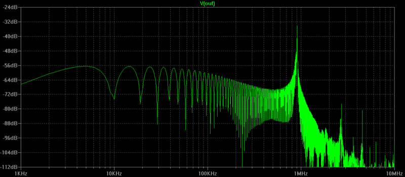

Would a simple tank circuit really eliminate harmonics? Perhaps you mean that the actual power level would be low and that the (very short) antenna response would also be low.
The graph in that post suggests it would be OK.
Another possibility comes to mind for the operation of this circuit. I have noticed that audio amplifier ICs, such as LM386, create large amounts of noise which extends far above the audio range. It is possible to hear this noise on a nearby receiver. If the IC is amplifying audio at the time, the signal is heard as amplitude modulated noise. It is so severe that if you use the IC with a ferrite rod receiver for the European Long Wave band, the ferrite rod will pick up the modulated noise signal and it will cause "howl round" or audio oscillation of the receiver. It looks to me that the audio IC supplies a noise signal to the transistor, extending up to the broadcast band, and also supplies modulating audio to the base of the transistor. The LC circuit will create a noise spectrum having the shape of the LC response.
Not if your "snapping" is band limited in the audio range.
Yes, this is the point the RF emission spectrum is essentially determined by the resonant tank properties, spread out a bit by the audio AM modulation. So, good Rx or Tx circuits use narrow filters of some sort.

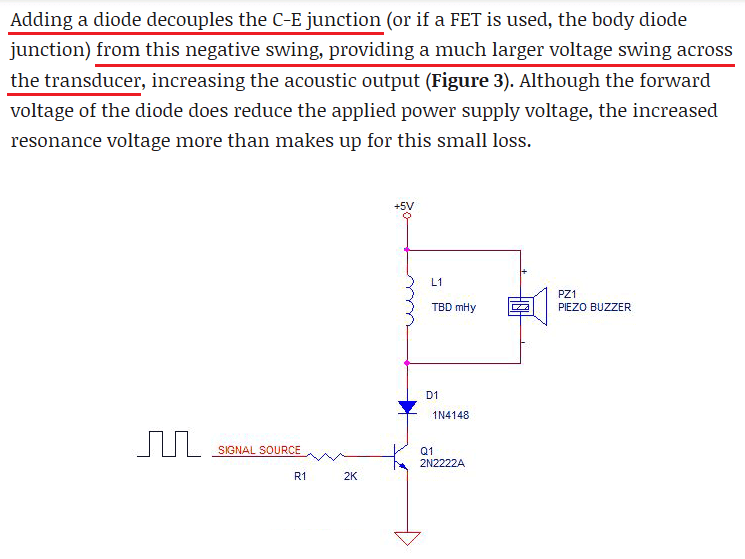

Just to share some information I found that gave me some light about the purpose of the diode:
https://www.edn.com/increase-piezoelectric-transducer-acoustic-output-with-a-simple-circuit/
This is for an acoustic transducer, but might be the reason the Elenco engineers included the diode.
And I found a printed Snap Circuits manual that mentions that the music IC provides the modulated audio signal in the system (I don't post the exact text here since I don't want to violate any copyrights law).

When a red LED is used for that diode, it sheds even more light on how a significantly greater voltage compliance can be available for ringing the LC tank. With an LED the 3V power supply also seems more appropriate.
The diode serves no useful purpose and looks to be in backwards, but no polarity of voltage is shown. There is little current limiting in the circuit, so the transistor may fail from excess current, except that the transistor has no bias. The inductor is a very poor antenna. How does it work? Poorly if at all.
  • #35
Turn it around and this transmitter will have an output cleaner than any other in existence. 😉
