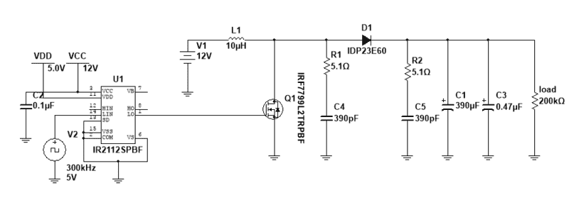

core7916
30
switching frequency is 300khz..
i am attaching boost circuit schematic.
yes sir simulated in multisim.

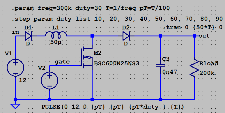

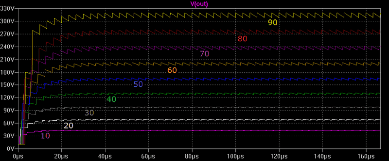

The reason for the clustering of output voltages for different duty-cycles is related to the mode of operation, influenced by the way current flows in the simulated inductor. If I place a diode, D1, in series with the inductor and supply, it performs without the clustering, and with different output voltages.
Percentage duty-cycle for traces are labelled in the same colour.
With D1
Without D1
Is that from the reverse recovery of D2? The simplest models say no current can flow that way. It seems it should be a pretty benign (soft) turn off for D2 in DCM mode.
Or maybe something about increased switching losses with the drain capacitance. Maybe quasi-resonant style? That kind of makes my brain hurt to figure out.
Baluncore
12,333
6,399
I do not yet know what mode it is, but I have managed to duplicate a clustered output simulation similar to the OP, with what I think is the simplest parameterised circuit in LTspice.
It does appear to be a bizarre π resonance involving the supply, inductor and the switch, but due to my other priorities, it will have to wait for the weekend before I will know if it is "too ideal" a model, or some real possibility. That is, unless someone else solves it first.
DaveE
2,920
2,589
Yes, that's guess too, unless you have a REALLY slow (or schottky) diode for D2. But I don't think it's bizarre. It is normal in SMPS when conduction stops for nodes to show LC style (parasitic) oscillations. But I don't understand how that consumes more energy than the non-oscillatory case of the drain voltage being left high and then dissipated resistively during the FET turn on. As I said it makes my brain hurt... or, maybe I'm just lazy.

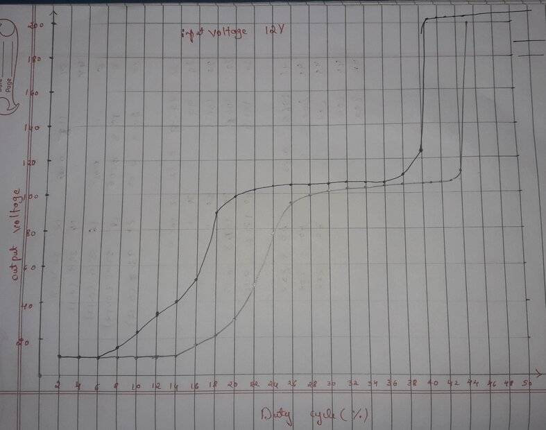

core7916
30
Hello.
While testing real time system i am getting profile like below.
I have given output voltage vs duty cycle graph.
In the test.
I am suppling 12v as input.
I am bit confused about waveform. Is this the corrct wave which i should get.

core7916
30
I see nothing below.
Sorry sir. I didnt attach file.
Below is the graph. I tested the circuit with different conditions. That is the reason for 2 curves.
Tom.G
4,741
3,498
Very good. I would guess those two conditions were with a Banana-Cream pie and a Hand-Grenade.
Am I close?
core7916
30
Am I close?
Sorry. That is with load and without load.
I am designing to actuate a piezo actuator.
Dont go with two curves. Take any one of the curve.
If you know why i am getting that profiel. Please tell us.

By waveform, or wave, I assume you mean the shape of the line on the graph. I can understand that a real circuit may have that parametric relationship. But I am not happy that you are testing a useful circuit. Is the circuit built according to your diagram in post #3 ?
Tom.G
4,741
3,498
What you are measuring (graphing) is the transfer curve of the boost circuit from the Gate of Q1 to the output voltage; specifically, duty cycle versus output voltage. The reason the two curves are shifted is that with a load connected, the duty cycle has to be higher to supply current to the load.
As @Baluncore said:
4. You need a controller with some feedback of output voltage to the regulator. That controller should limit the inductor current when there is a short circuit.
What type of controller are you contemplating ?
To say it another way, you need additional circuitry that senses output voltage and then controls the switching of Q1. The 'feedback' circuit will automatically shift those two load/no-load curves as needed to maintain the output voltage you design for.
This circuitry could either:
  1. Shut off the drive to Q1 when the output voltage gets too high,
  2. or it could decrease the duty cycle at high output voltage.
Note also the diode (D1) that @Baluncore added and the changed L1 value:
With D1 he seemed to get pretty good linearity of duty cycle vs output voltage.
Hope this helps!
Cheers,
Tom

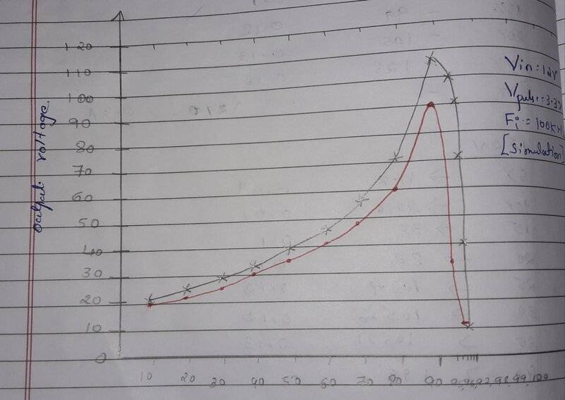

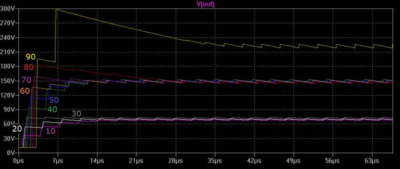

core7916
30
Sir i already tried with the circuit , baluncore suggested. Still getting the curves that i have given previously.
I have simulated the circuit in multisim and i got the graph . Which i have attached. If we compare both simulated and real time graph, there is no simularities.
I dont know how thease differes since i am testing same circuit real time. (Components are different in simulation and real time).
I am new to thease i dont have much knowledge about feedback circuitry
Reference: https://www.physicsforums.com/threads/analysis-of-boost-converter.1050594/
Red line : 300khz switching frequency.
grey line : 100khz . ( simulated in multisim).
Baluncore
12,333
6,399
Re: Post #17. How can you measure a stable output voltage, when you have no load, what stops the output voltage from continuing to rise ?
Re: Post #22. The two curves need to be simulated and measured at the same switching frequency, and the load must be specified.
I cannot simulate your circuit in LTspice because;
1. I do not have models for the same devices as you.
2. It takes too long to settle the output voltage.
