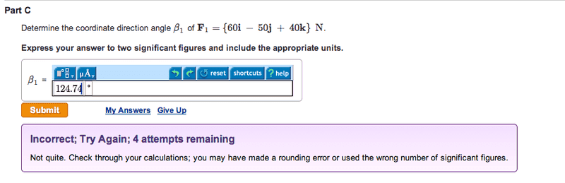

Find Beta of <60,-50,40>
Cosine β = Ay/lAl
lAl = 87.74964387
So its arccos(-50/87.75) = 124.62
express to 2 significant figures and it keeps telling me I am wrong. I rounded to 125. kept at 124.62.. etc.

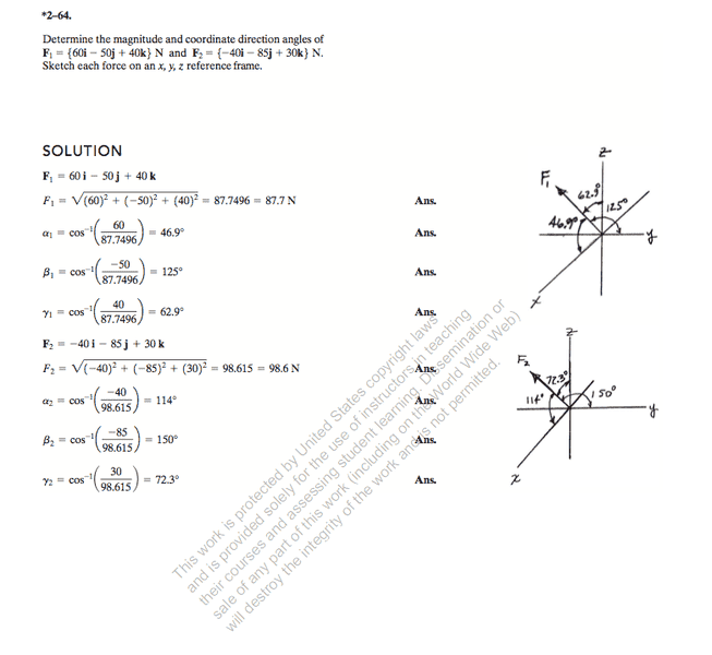

And i got the answer book telling me this
The book answers are clearly expressed to three significant figures. What is your correct response for the angle you determined expressed to two significant figures?
Online it tells me to do 2 sig figs.
And it's 125 degrees
No, that is three significant figures. What is 124.62 degrees expressed to two significant figures??
I honestly don't know because it clearly has 3 at 125
How would I make that 2 sig figs
I am not an expert on significant figure rules, but you can find them through Google and other search engines. But here is a hint: 141.635 rounded to four sig figs is 141.6. If rounded to three sig figs it is 142; that same number rounded to two sig figs is 140. And that same number rounded to one sig fig is 100.
